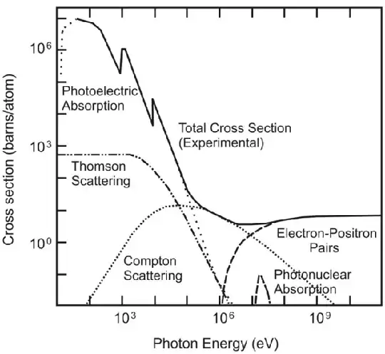

The answer is, it does happen. Just at largely different energies. This picture (taken from this thesis, page 10) summarizes it quite nicely for scattering on Cu (Copper) atoms: Contribution to the photon-atom cross-section
Photoelectric absorption is just the most relevant effect at low energies (as you can see from $10 - 10^3$ eV.
Let me summarize the other effects ($A$ stands for atom):
  • Thomson scattering ($\gamma + e^- \to \gamma + e^-$): Photon is absorbed and emitted by an electron (also called elastic because the electron does not absorb energy) (also called Rayleigh scattering)
  • Compton scattering ($\gamma + e^- \to \gamma + e^-$): Photon bounces off the electron and kicks it out of the electron as well (also called inelastic because the electron absorbs energy in the process)
  • Photonuclear absorption ($\gamma + A \to A^*$): Honestly, I did not know about that one. The core seems to absorb the photon and become excited, but that only happens for specific energies, depending highly on the core.
  • Pair Production ($\gamma + A \to e^+ e^- + A$): Finally, as you guessed, pair production plays a role at above 1 MeV. But not exactly as you state it. It is true that a photon cannot turn into an electron positron pair in the vacuum due to momentum conservation. However, close to an atom, the atom can absorb some of the momentum to achieve the conservation. But the electron and positron in this case will still be so fast the they just fly past the atom and the positron does not annihilate. Wikipedia shows the following Feynman diagram: Feynman diagram of electron–positron pair production
So, the answer to "what happens" is quite complicated, lots of different things happen depending on energy. Usually, you do not need the full picture (as for low energies). But it's good to have an overview.
Let me know if there are any errors in my answer!
