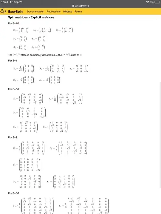

What is the general form of the Pauli matrices for a $3\times 3$ matrix (spin $s=1$)? Do these generalized Pauli matrices satisfy all the properties exhibited by the Pauli $2\times 2$ matrices, such as being Hermitian? Furthermore, is it possible to represent all Hermitian $3\times 3$ matrices using these generalized Pauli matrices?

As @Charlie asks, the Pauli matrices have several properties, which generalize in different manners. They certainly, together with the identity, provide a complete basis for 2×2 matrices, but they are also hermitian. If Hermiticity is important to you, you generalize them as in the link provided, that is along the Gell-Mann matrices' route for 3×3 matrices.

Pauli matrices (plus the identity matrix) are just a choice of matrices that allow decomposition of an arbitrary 2-by-2 matrix - i.e. a matrix with 4 independent parameters. One could choose them differently, so this particular choice is more due to the tradition and the fact that all the three matrices are already Hermitian. It is not uncommon to use $\hat{\sigma}_\pm$ instead of $\sigma_{x,y}$.
For 3-by-3 case one needs in principle 9 matrices, one of which can be the identity matrix. They also can be all chosen Hermitian. However, one will have more freedom than in the 2-by-2 case. This freedom might be further restricted by a particular application - e.g., describing certain type of rotations.
