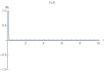

Let's first see how the $\phi_5(r,t)$ looks. This will enable us to compare it with $\phi_4(r,t)$. The following animation uses $\sigma=0.005.$
phi_5(r,t) with sigma=0.005

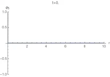

We can see that it basically has two spikes: one positive and one negative. Let's increase $\sigma$ to $\sigma=0.04$ to resolve them better:
phi_5(r,t) with sigma=0.04

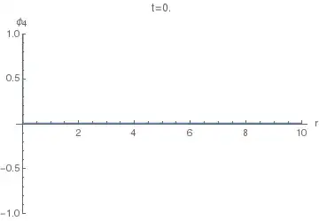

Now we can finally look at $\phi_4(r,t)$. The following animation uses $\sigma=0.005$, as the first one above.
phi_4(r,t) with sigma=0.005
Notice the difference of this wave from the $\phi_5(r,t)$: the former has a "tail" inside the light cone, i.e. on the LHS of the positive spike here. This tail corresponds (in the limit $\sigma\to0$) to the second, negative, term in the equation $(36)$, while the positive spike corresponds to the first term with the Dirac delta.
So, the answer to
What does it mean that the Green’s function for the 4+1D wave equation has an opposite sign delta-function exactly on the light cone?
is exactly that: there is a negative wake inside the light cone and the opposite sign, i.e. positive, Dirac delta, i.e. infinitely high and narrow spike, on the light cone.
