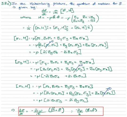

The (well my professor's, and so I would like to mimic her style as she's brilliant) solutions to the problem we got after trying this for HW last week makes a step that I am confused about:
Why is the operator $\vec{\sigma}$ not transformed to the Heisenberg picture? Ought we to first send
$$ \vec{\sigma} \rightarrow \vec{\sigma}_H=e^{\frac{it}{\hbar}H}\vec{\sigma}e^{\frac{-it}{\hbar}H} $$
My only thought is that my professor already did so! See the following work from a similar problem I found on the web. The Hamiltonian in this work's case is more specific,

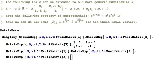

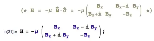

Now... if I define my generic Hamiltonian:
where I use the Pauli vector now for the more generic Hamiltonian instead of one of the matrices like the example above... the same formula for $(\sigma_x)_H$ is .... disturbing.
Can someone point out my mistake (computational or conceptual) and point me to how I can show $\vec{\sigma}_H=\vec{\sigma}$

This seems correct to me, but if so, the result $[H,\vec{\sigma}]=0$ reduced the Heisenberg EOM to
$$ \frac{d}{dt} \vec{\sigma} = 0 $$
which I know to be false... :/
My thoughts at the moment is that my $[H,\vec{\sigma}]$ is wrong based on my professor's calculation above where she does NOT factor out the constant $\vec{B}$. I was motivated to factor out based on this Stack answer.

Clearly $\exp(\hat A)\hat A\exp(-\hat A)=\hat A$ by Baker-Campbell-Hausdorff. Here, set $\hat A=\hat H=-it\mu\vec B\cdot \vec \sigma/\hbar$.
Note that \begin{align} \exp(-i t\mu \vec B\cdot \vec \sigma/\hbar)\ne \exp(-it B_x\sigma_x)\exp(-it B_y\sigma_y)\exp(-it B_z\sigma_z) \end{align} or any other kind of factorization suggested by your snippet of Mma code since in general $\exp(A+B)\ne \exp(A)\exp(B)$. The correct implementation would be to compute $-it\mu\vec B\cdot\vec \sigma/\hbar$ as a single matrix and then exponential this single matrix.
