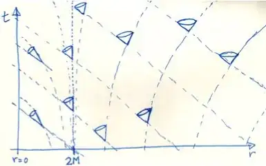

Now let's look at the $r, t$ lightcone around a black hole:
(source: asymptotia.com)
Once you've crossed the event horizon, all worldlines move backward in $r$. So we say that $r$ becomes timelike while $t$ becomes spacelike.
In the Schwarzschild metric,
$$ds^2 = -\left(1-\frac{2GM}{r}\right)dt^2 + \left(1-\frac{2GM}{r}\right)^{-1}dr^2+r^2d\Omega ^2, $$ We can see that for $r > 2GM$, the terms in the parenthesis are positive, and therefore the timelike coordinate is $dt$, since it already has a negative sign outside it. But for $r < 2GM$, the terms in the parenthesis are negative, so the time-spacelikeness of $dt, dr$ flip, and $dr$ becomes the only coordinate that contributes negatively to the metric line element. What this means physically is that you can only move forward in $r$, so in that sense $r$ becomes a timelike coordinate. A bit more pondering should reveal that this mathematical treatment of the problem reproduces the well-known black hole behavior exactly. (Can't go back when you've crossed the event horizon).
