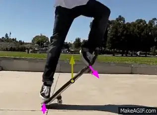

The answer by @NuclearWang is correct, but I wanted to illustrate the process a bit. At least the initial part that sets things up for the stunt.
  • Stage I
    Stage-I
    At this stage, the foot pushes downwards, but the reaction from the ground is greater because the center of mass (yellow dot) must move upwards, due to the kinematics of where the pivot is. For the whole time before the riders foot touches the ground, the center of mass of the board is accelerating upwards (acquiring vertical momentum)

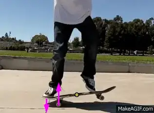

  • Stage II
    Stage-II
    This is the part I missed originally. The back foot causes rotation which is resisted by the front foot, while the foot is sliding upwards causing the sliding friction to add to the lift on the skateboard. This is important as kinematically the rotation of Stage-I can only lift the center of mass so much, and then it stops. To accelerate upwards more, a lift force is needed.

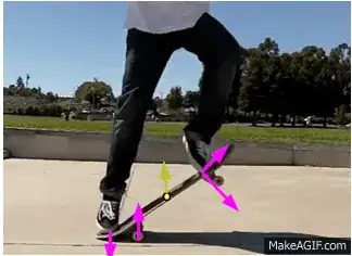

  • Stage III
    Stage-III
    Once enough vertical velocity (yellow arrow) is accumulated by the center of mass and the end of the board strikes the ground, this reaction causes the wheel to lift off. At this point, if the board was allowed to continue to rotate it would pivot about its end launching itself between the rider's legs (not pleasant). At this point the rider's other foot stops the rotation with a slight nudge, leaving only the vertical motion allowing for the board to lift off completely.

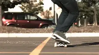

Others here have given great answers about the physics behind this, but I would like to describe the actual approach of this skateboard stunt known as an Ollie. I'm a skateboarder myself and I regularly use this maneuver to jump onto and over various obstacles including curbs, boxes, and metal rails. Think of the skateboard as a simple seesaw in a way. Weight on one end tilts it down, and weight added to the other end levels it out, although the actual process is a little more complicated and takes thousands of attempts to master.
An Ollie starts with the rider jumping up and pushing the tail downwards in a snapping motion with the back foot. This causes the skateboard to pop up to an extent and start to stand up on it's tail. The actual "lift" of the skateboard is mainly generated by the front foot dragging across the top of it to pull it upwards with the body. Once the front foot hits the nose of the board, the foot is moved forward to level the board out in the air. Doing so allows the board to stay as close to the feet as possible to maintain full control over the stunt throughout the entire process. A lot of beginners will forget to move the front foot up/forward which leads to the board briefly rising up on the tail and then falling back down without leaving the ground.
Notice the position and angle of the front foot before the jump is initiated. The further back the front foot is, the more the board will raise up with the jump as this allows the board to stand up more ("increase in the angle of attack") before being pulled upwards with the front foot. Having the foot slightly angled makes it easier to keep the outside of the foot in contact with the board as the foot is moved upwards and forward.

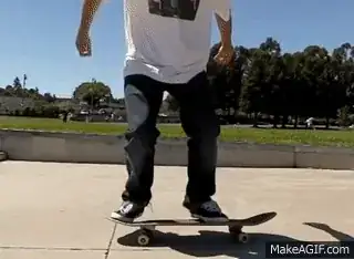

It's not so hard to understand what causes the upward jump (of course you have to jump in the right way to provide a torque on the board; that's something that one learns instinctively in time). But why does the board stays all the way close to the boy's feet?
As you can see in the clip, by pushing with his right (left in the clip) against the back of the skateboard, which causes the board to rotate. With his left foot, he stops the rotation and the reaction of the board is to stop rotating (it has to conserve it's kinetic energy though, so the rotational kinetic energy is converted into kinetic energy of a linear moving object, which can clearly be seen in the clip; the motion of the board starts with rotating and ends up moving linearly, staying parallel to the surface) thereby being able to stay close to his feet. The right (left in the clip) side of the board after the reaction, moves upwards after the guy has stopped it with his left foot.
