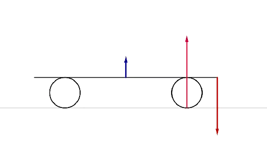

We begin by pushing down hard on the right-hand side of the skateboard, to the right of the wheels. This creates a large torque about the right wheel and makes the skateboard start to rotate up off the ground. The upward momentum is provided by a large normal force from the ground. Here is a picture at the first moment, when the skateboard has zero velocity.
The red arrows show the forces. The blue arrow shows the acceleration of the center of mass. The torque about the right wheel is into your monitor.

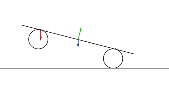

The skateboard gains a significant amount of momentum upwards in this way. If we left it alone, it would fly up in the air, flipping, and moving to the right. Instead, we push down on it on the left hand side. This induces a counter torque and reduce's the skateboard's upwards momentum. Here is a picture before the skateboard leaves the ground, right when the force on the left wheel is first applied.
The red arrows are forces and the blue arrow is the acceleration again. The green arrow is the velocity of the center of mass. The torque is now in the opposite direction - out of the page. In the next moment, the skateboard's center of mass will continue to rise and move a little to the right, but also the skateboard will begin losing angular momentum. It will stop rotating, then rotate back to the flat position. In the mean time, its inertia will raise it off the ground.

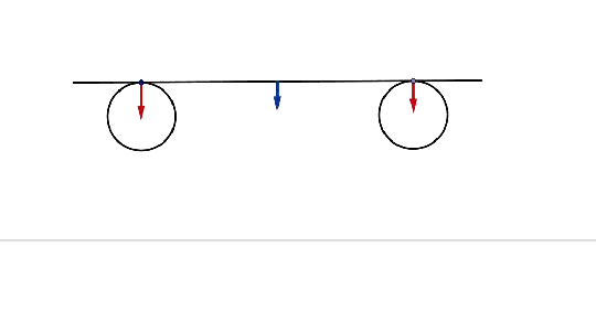

Now both feet push on the board as we fall. Here is a picture of the board at its highest point, with the velocity again zero, and the feet pushing equally down.
