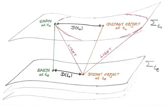

In the 3+1 formalism of General Relativity, spacetime is described as a foliation of spatial, i.e. 3-dimensional, hypersurfaces along the time-axis. In the figure, each slice $\Sigma_t$ represents 3-dimensional space at a given time $t$.
Foliation of Spacetime. Light is emitted from a distant object at time $t_e$ and reaches Earth at time $t_0$.
Looking into the past
Since light is locally always traveling with the speed of light, $\mathrm{c}$, on large length scales it becomes important that light that reaches the observer on Earth at a time $t_0$ ("today") has been emitted at its origin at a time $t_e:<t_0$, i.e. earlier than $t_0$.

A reasonable thing would be to ask for the size of the universe as it is today, i.e. to ask for the proper distance, as shown in the figure.
But, most commonly, the scale factor $R(t)$ is defined such that $R(t_0)=1$. Therefore, if we ask for today’s particle horizon, $r_p$ ($t=t_0$), there is no difference.
$$ r_p := D_p(t_0) = x_p \, R(t_0), \ \ \ R(t_0)=1 $$
