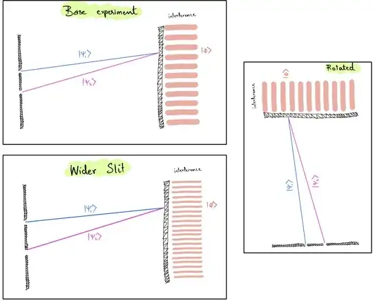

Consider the example of the double slit experiment. The phase difference between the two states corresponding to the two different paths is what leads to the interference pattern. Changing the slit width changes introduces an extra phase difference between the paths as compared to our unchanged slit width. This means the interference pattern is altered. Leading to a different physical state.
On the other hand, if we just rotated the whole system by some angle leaving everything else unchanged, then the final pattern is unchanged albeit rotated by an overall angle. This is the effect of the overall phase.
