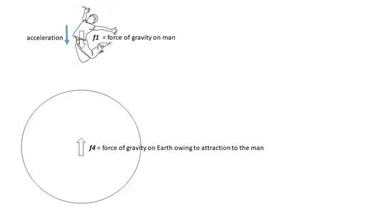

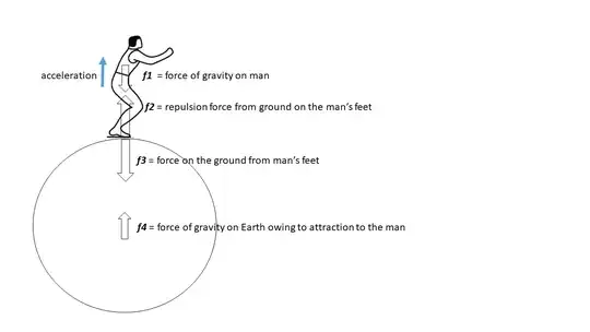

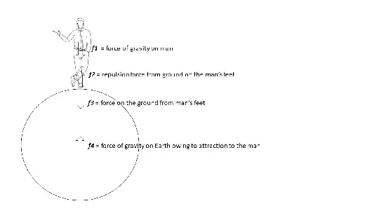

Here are the forces: enter image description here
$f_1$ and $f_4$ are owing to gravity; they are of equal size and opposite direction.
$f_2$ and $f_3$ are owing to electrostatic repulsion; they are of equal size and opposite direction.
Here $f_2$ is just balancing with $f_1$ so the man is not accelerating. Gravity is not especially strong or weak compared to the electrostatic force here. They both have the same size.
This picture shows a man who has just started to make a leap; his centre of gravity is accelerating upwards. Now the force on his feet ($f_2$) is larger than his weight ($f_1$). This is because the chemistry in the muscles have caused the muscles to expand, so he both pushes the Earth away and his centre of mass begins to accelerate upwards. The Earth also accelerates but since it is so heavy this acceleration is negligible.
And here he is in freefall.
Newton's third law says the forces come in equal and opposite pairs, as indeed they do, but note that the partners in each pair act on different objects, and the parts of each pair are owing to the same interaction. They are two parts of one interaction, whether gravitational, or electrostatic, or whatever. It is fairly easy to jump off the ground, so gravity is not all that strong. The reason it is hard to jump right into orbit is that gravity keeps acting on you all the way up, whereas the force you can apply with your feet against the ground only acts for a short moment at the beginning of the jump. If you had a rocket pack offering just a little more force than your weight then you would keep on accelerating up and away. You will need a lot of fuel though.
