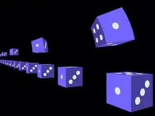

I can convince myself of being able to see a wall that is facing at most 90° away from me, based on the assumption that I'd see photons emitted from it in the direction parallel to the surface. How could I ever observer photons from a wall that's facing more than 90° away? Some of the references clearly show walls that were originally facing away from the observer as visible, like the wall with 4 dots on the moving dices:
https://www.spacetimetravel.org/tompkins.jpg
Are those mistaken?
Concentrate on the nearest top die on the right. The reason you can see the "four" face is that you have already passed the "one" face of the die! It is just that aberration has distorted the image to place it in front of you. There is nothing more to "Terrell Rotation" than this simple fact.

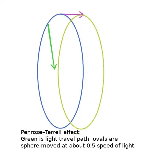

As far as I know that effect has not been demonstrated experimentally, but if we try to imagine light travel in discreet time intervals, we can see sphere (and the dice I think too) has time to move out of light's way (object is also length contracted in observers frame of reference, which afaik is not essential to the effect, but allow us to see even more "behind", at least for some shapes). Note: the image below I have drawn shows length contraction of about 50% which is at speed of ~0.85c, not 0.5c.

Suppose the die is at rest and you do a flyby while shooting pictures. But, oddly, you accelerate to a stop relative to the die before taking each picture, then accelerate back to your former velocity to move to the next location. Your path is such that the earlier photos show the 1 and 3 faces, the middle photos show the 1 face alone, and the later photos show the 1 and 4 faces. They look normal and undistorted since you're at relative rest.
Now you do the same flyby, taking pictures at the same locations, but without stopping when you take them. The pictures you take on the second flyby will be like the pictures on the first flyby but distorted by aberration and Doppler shift. Doppler shift is irrelevant here so we'll ignore it. The effect of aberration is to shift the location of the cube on the film toward the direction of your motion (the so-called headlight effect). It also distorts the straight edges of the cube into arcs of circles, but that's not important.
Now – here's the key part – you decide to only look at the photo from each flyby where it appears the cube is located at a right angle to your direction of motion. In the first flyby, that's the middle photo, and it shows only the 1 face. But in the second flyby, it's an earlier photo, because aberration moved the cube closer to the forward direction in all of the photos. The earlier photo shows the 1 and 3 faces.
Your motion doesn't make any face visible that wasn't visible when you were at rest. You'll never see the 6 face (opposite 1) while moving on this path because you'd never see it in the photos taken at rest on that path. You only see different things in the two selected photos because you used a somewhat silly criterion for selecting them.
