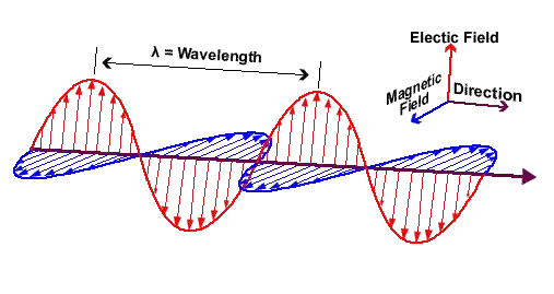

Second, photons are often depicted as a magnetic field and an electric field oriented 90 degrees from each other, perpendicular to the direction of travel of a photon, such as this image: Photon electric and magnetic fields
Can that field have any orientation relative to some fixed reference? Can I have two photons where one's fields are perfectly aligned with my frame of reference, but the other is rotated?
