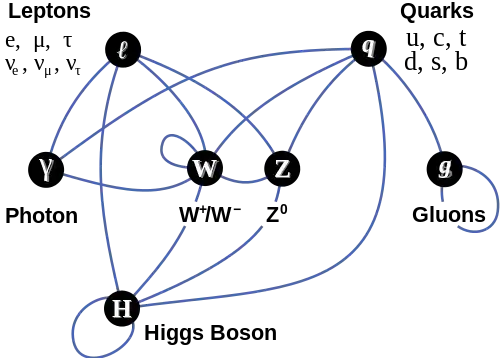

Not only does gravity have a vastly weaker magnitude, it also has a very strange interaction with everything else. Consider the Standard Model interactions:
Standard model interactions
No particle (or field) interacts directly with all other fields. Heck, gluons only barely interact with the rest of them. So why is it then that anything that has energy (e.g. everything that exists) also has a gravitational interaction? Gravity seems unique in that all particles interact through it.

That's the picture of General Relativity. The electromagnetic, the weak and the strong force are the real forces. The formulation of these forces as Quantum Field Theories is called the Standard Model. This is the model you pictured.
Quantum Field Theory is typically formulated in flat spacetime, without curvature. So it does not include gravity at all and it does not refer to gravitons. Thus, the Standard Model is only an approximation. We know that the spacetime around the Earth is curved. Working with the Standard Model we approximate this curved spacetime by flat spacetime. This approximation works out pretty well since the curvature caused by the Earth is not too great. So, we neglect gravity altogether in the Standard Model. It only works, because the effects of gravity are so small when conducting experiments on the Earth.
