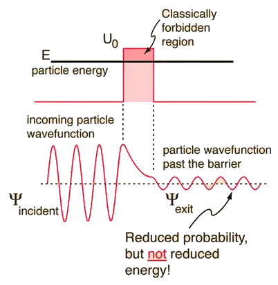

The simplest physics description of potential barrier tunneling can be found here:
tunneling
According to classical physics, a particle of energy E less than the height U0 of a barrier could not penetrate - the region inside the barrier is classically forbidden. But the wavefunction associated with a free particle must be continuous at the barrier and will show an exponential decay inside the barrier. The wavefunction must also be continuous on the far side of the barrier, so there is a finite probability that the particle will tunnel through the barrier.
Note it is the same energy level occupied by the particle inside or outside the barrier, it is the wavefunction $Ψ$ that is affected, i.e.the probability $Ψ^*Ψ$ of finding the particle at a particular x, in this one dimensional representation.
It is all quantum mechanics after all, a matter of probabilities, there is no change in energy so there is no problem.

In the image above, the energy is negative counted from the top of the well and continues negative counted from the top of the well,or positive, if the zero is defined at the bottom of the well.

The issue is that position eigenstate and energy eigenstates are incompatible. That is, if position is measured, the state then becomes a superposition of energy eigenstates. And vice versa.
So it doesn’t make sense to ask what the energy is in a localised region of space. The system doesn’t have those properties simultaneously.
