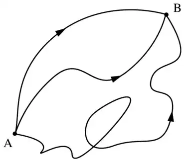

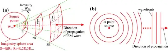

There are mainly two thoughts:
  1. the photon travels in a straight line, and that explains why it only interacts with a certain atom, meaning, that the photon can only be detected once, and the photon will not interact with the other atoms because they are out of its trajectory
  2. the photon takes all paths, and that is why it truly goes through all possible avenues, explaining experiments like interference
Now these lead to two different propagation pictures. On the top, you can see the photon (EM wavepacket) spreading spherically in all directions. On the bottom, you can see a photon traveling from A to B, taking all possible paths.
But which picture could be experimentally proven to be correct? The picture on the top cannot explain why the photon misses all the other atoms, that is, why it is not interacting with other atoms, because all atoms are in its way basically (it spreads spherically). The picture on the bottom cannot explain diffraction, because the photons is shown not to spread like a wave (cannot interfere), but just like a billiard ball on different paths.

The folklore picture where a photon runs all possible paths is actually a popular illustration of the Feynman path integral method to deal with quantum particles. Actually it is a quite technical machinery which cannot be reduced to this popular representation. Literally taken it may produce mistakes.
Do photons take all paths or not?
Yes, they take all paths. This can be seen by single photon sources and:
Double slits Diffraction gratings Lenses Etc.
For me, the diffraction gratings are the most convincing.

Even in classical electromagnetism, Huygens' principle says that you can treat each point on a wavefront as a source of new waves traveling in all directions – or to put it another way, that you can replace the classical wave picture with one in which light is pointlike and "takes all paths", including non-straight paths.
The difference between quantum and classical light is that classical light is made of infinitely many of these particles, while quantum light is made of finitely many. Looking again at the classical case, if you consider only the infinitesimal amount of light that is absorbed at a particular point, you can think of it as spreading out from its point of emission and then "homing in" on its point of absorption (because paths outside of the past light cone of the point of absorption don't contribute). This is also a reasonable picture of a quantum photon between emission and absorption. You could also think of the photon as being in a superposition of "homing in" on every spacetime point, with the choice being made later at measurement/collapse time.
benrg
  • 29,129
We don't know the path of a photon. Indeed, I wonder if the concept makes sense in quantum mechanics. We only know its wave function. The wave function is everywhere but, due to interference, far from the source you end up with the Frauhofer result.
