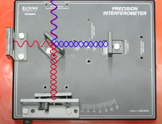

First off, a Michelson interferometer does work. It can measure tiny length differences. Here is a video showing one in action.
I must have misunderstood how it works. Here's what I think is happening:
The light beam is split in two. The different paths may be different lengths. They are then recombined, and so they may interfere.
light path in interferometer
To see the interference, the light goes through a pinhole that is multiple wavelengths wide. The light spreads out in all directions, and when it hits a flat wall anywhere but the center, the light that went through different parts of the hole will have traveled different distances. So it interferes.
All that matters is the geometry. The first dark circle comes at a place where the light from the far end of the pinhole has traveled one wavelength farther than the light from the closer end. So it cancels.
Since the wavelength is the same for the two beams that were split and have come together, each of them cancels with itself at that spot. Also at the spot where the total difference is two wavelengths, and three wavelengths, etc. So those rings will always be dark. But the places where the light constructively interferes, the two beams may cancel there, or complement each other. So we can tell about tiny differences in length by how bright the unmoving bright circles are.
But that isn't what actually happens! In the video, when one mirror is moved a little, the rings actually move! They don't just get brighter or darker, they stay the same brightness but move outward, or back in.
So my understanding is somehow wrong.
What is really going on here?
A Michelson interferometer measures minute changes in the path length difference between the two interferometer "arms" by measuring the fringe shift of the interference pattern produced, not the changes in brightness. This is because changes in the length of an "arm" produces a phase shift in the light, which in turn shifts the interference pattern.

It seems you have understood the more complicated part of the problem, which is why ring patterns appear rather than just a uniform brightness. The rings are caused by angular path length differences. The easier part of the problem is the linear arm length differences. By moving the one arm you change the path length difference, causing any point in the ring pattern to modulate in brightness. Just because the rings "move" doesn't mean any given point in that pattern isn't modulating as the arm moves.

Yes, typically for simple toy models of a Michelson interferometer we assume the wavefront of the beam entering the device is flat (basically a plan wave, or in practice a Gaussian beam with a relatively large waist. We also assume there is no angular misalignment. In this case, as you point out in your edit, there is no spatial interference pattern.
However, if you look at the total intensity pattern as a function of the path length difference between the two arms you will observe a sinusoidal modulation of the intensity. This is because of the interference of the two beams falling on the detector so will stay say there is an interference pattern. It is just that in this case instead of appearing as an interference pattern in space (seen as bright and dark fringes) it appears as an interference pattern as a function of path length difference.
This is an important feature of interference patterns, it is some sinusoidal signal which arises due to the superposition of two things, but the horizontal axis for this sinusoid can be many different things, it can be space, in which case we might see fringes just by looking, it might be time in which a signal oscillates, or it might be some other parameter such as path length difference.
