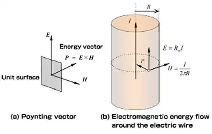

Let's calculate the magnitude and direction of the vector for a wire with uniform current I flowing through it, as shown. enter image description here
The Electric field E inside the wire points along the direction of I, and is equal to $\frac{V}{L}$, where V is the potential applied, and L is the length of the wire. The Magnetic field is always perpendicular to the Electric field at all points on the surface, and is equal to $\frac{\mu_0 I}{2\pi r}$ (denoted in the diagram by H).
The cross product therefore always points perpendicular to the surface inwards. The magnitude of $\oint\frac{1}{\mu_0} (\mathbf{E\times B})\cdot d\mathbf{a}$ surprisingly yields $VI$, which is indeed the power consumed by a wire having uniform current flow.
Thus, we find that some sort of energy is flowing into the wires. But from where?

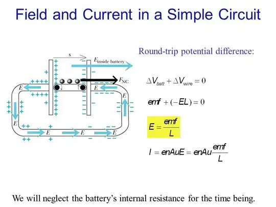

Now look at this diagram.enter image description here
The current in a circuit always flows in the same direction, inside as well as outside a battery. So, the magnetic field lines always remain the same. However, the electric field inside the battery must reverse its direction, as shown (ignore the writings).
So, the Poynting Vector must remain the same in magnitude but change its direction, now pointing perpendicular outwards from the surface of the battery.
