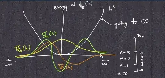

In general, the energies of a mode are proportional to $h^2$ where $h$ is the amplitude of the mode and a wave function of the mode $\Psi(\Phi_{\vec{k}}(h))$ is the probability amplitude of the mode $\Phi_{\vec{k}}$ having the amplitude $h$. However, the energy levels of the mode are quantized (like in the quantum harmonic oscillator) so that there is a wave function for each energy level $n$ labeled $\Psi_n(\Phi_{\vec{k}}(h))$ for $n = 0$ to $\infty$.
Sean Carroll's Diagram: enter image description here
Finally, he says that an interpretation of the $n$th energy state $\Psi_n$ for the mode $\Phi_{\vec{k}}$ is as follows:
Since $\vec{k}$ represents the momentum of the mode, $\Psi_n$ is the probability amplitude of measuring $n$ particles with momentum/wave number $\vec{k}$.

Always remember that the point of view of a single individual may contain certain biases that can skew one's understanding. As a general principle, always gather as much information from diverse sources to get a better picture.
I don't want to say anything negative about Sean Carroll's video, but perhaps he is making the situation a bit more complicated than it needs to be in an attempt to be as general as possible.
Although the wave function of a multi-particle state can be rather complicated, the wave function for a single particle is essentially the same as that of the classical field. In other words, if the field $\Phi(x)$ in the classical case obeys the equations of motion, then in the quantum case for a single particle $\Phi(x)$ would be the wave function (barring some dimensional changes) that would obey the same equations of motion. The same equations of motion should govern both the classical field and the quantum wave function.
This can be confirmed experimentally. One can use a small detector to measure the classical optical field at different locations $x$. In the quantum case, one can use a single photon detector to measure the wave function as a function of $x$. If the initial conditions that produce these fields are the same, then the functions would be the same. In both cases, the measurements give us $|\Phi(x)|^2$. In the classical case, it is interpreted as a local intensity and, in the quantum case, it is a probability, but other than that they are the same.
For multiple particles, there are more possibilities. What makes it complicated is the fact that the different particles can have different wave functions and, on top of that, one can have superpositions of different such combinations. However, such complicated state are difficult to produce. Usually, all particles in a multi-particle state would have the same wave function. In that case, it is very much like the classical case. In fact, in the limit of a large number of particles with superpositions of different numbers of particles all having the same wave function, the state can essentially be considered a classical state. That is what one has with a coherent state.
