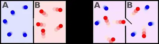

I was reading this article from Ethan Siegel and I got some doubts about a sentence about entropy, specifically when Ethan explains the irreversibility of the conditions of the hot-and-cold room, as in this figure:
entropy
In his words:
It's like taking a room with a divider down the middle, where one side is hot and the other is cold, removing the divider, and watching the gas molecules fly around. In the absence of any other inputs, the two halves of the room will mix and equilibrate, reaching the same temperature. No matter what you did to those particles, including reverse all of their momenta, they'd never reach the half-hot and half-cold state ever again.
My question is:
Is the spontaneous evolution from the equilibrium temperature (right side of the image) to the half-hot and half-cold state (left side) physically and theoretically impossible/forbidden, or is it simply so astronomically unlikely (from a statistical perspective) that in reality it never happens? The article seems to suggest the former, but I was under the impression of the latter.

The appropriate mathematical tool to understand this kind of question, and more particularly Dale's and buddy's answers, is large deviation theory. To quote wikipedia, "large deviations theory concerns itself with the exponential decline of the probability measures of certain kinds of extreme or tail events". In this context, "exponential decline" means: probability that decreases exponentially fast with the increase of number of particles.
TL;DR: it can be shown that the probability to observe an evolution path for a system that decreases entropy is non-zero, and it decreases exponentially fast with the number of particles; thanks to a statistical mechanics of "trajectories", based on large deviation theory.

What you are interested in is Crook’s fluctuation theorem. It gives the probability of going “backwards” thermodynamically. Specifically, the theorem says:
$$\frac{P(A\rightarrow B)}{P(A\leftarrow B)}=\exp \left( \frac{1}{k_B T}(W_{A\rightarrow B}-\Delta F) \right)$$
In the case of the box, $W_{A\rightarrow B}=0$ so the probability is purely driven by the change in Helmholtz free energy, $\Delta F$.
No.
Yes.
