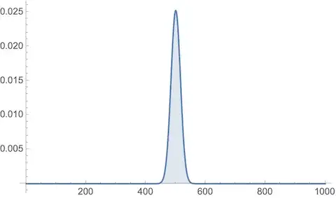

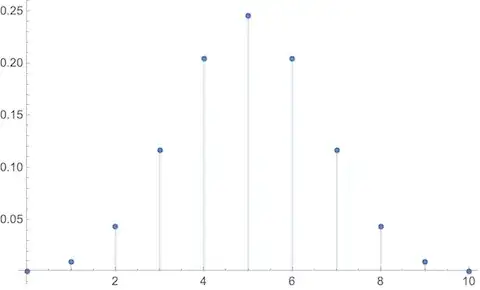

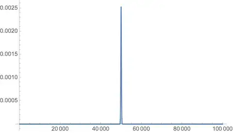

Suppose you flip a fair coin $N=10$ times. You would expect the number of heads $n_H$ not to differ too much from the number of tails $n_T = N - n_H$, but you wouldn't be surprised if you got, for example, $n_H = 8$ heads and $n_T = 2$ tails. Indeed, we can plot the probability distribution of outcomes, and see that it is peaked around $n_H = 5$.
One way to think about why this is is that if we look at all the possible sequences of heads and tails resulting from our flips, there are more sequences with similar numbers of heads and tails than there are sequences with different numbers of heads and tails. For $n_H = 5$, we could have HTHTHTHTHT, HTTHHTTHHT, etc., but for $n_H = 10$, there is only one possible sequence of outcomes, namely HHHHHHHHHH.
As we increase the number $N$ of coin flips, the distribution becomes more sharply peaked about $n_H = N / 2$, meaning we're increasingly likely to observe similar numbers of heads and tails. Here are the same plots for $N=10^3$ and $N=10^5$:
I can't get my computer to make a similar plot for $N=10^{23}$, but you can imagine if I did it would be just a tiny needle of a peak situated at $n_H = N / 2$. What is happening is that when $N$ is large, there are so many more sequences with similar numbers of heads and tails that it becomes increasingly improbable that we'll find large differences in these numbers (relative to the number of coin flips.)
This is only an analogy, but the essence of the 2nd law is here. The analogy is that the the strings of outcomes are like the microstates of our system with $N$ constituent subsystems, and the number of heads is like a thermodynamic variable (a statistic) specifying the macrostate of our system. The entropy counts the number of microstates corresponding to a given macrostate (like the number of sequences of heads and tails containing a given number of heads). The 2nd law says that in thermodynamic equilibrium, the most probable macrostate is the one with the largest number of microstates, assuming the microstates are are equally probable. That is, the entropy of a macroscopic system in thermodynamic equilibrium is maximized.
Is it possible in theory for a macroscopic system to be in a state that doesn't maximimze the entropy? Sure, but the probability of this happening is so fantastically unlikely — like flipping $10^{23}$ coins and all of them coming up heads — that in practice we will never observe this happening. This is the reason that physicists are confident that the 2nd law cannot be violated.
