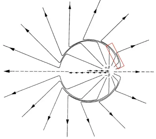

You're right: if there were just a Coulomb field outside some expanding shell, and a different Coulomb field inside the shell, then Gauss's law wouldn't hold, as can plainly be seen by drawing a Gaussian surface that straddles the shell.
However, the shell itself contains an additional, transverse electric field. This is the pulse of radiation produced by accelerating the charge, and it ensures that the flux through the Gaussian surface is zero. To see this visually, note that having zero flux through a Gaussian surface is equivalent to an equal number of electric field lines enter and exit.
Now consider the Gaussian surface drawn in red.
Four field lines enter it radially and only one exits radially. But three extra field lines exit transversely, so the radiation field ensures that Gauss's law keeps working. (And it keeps working no matter how quickly you kick the charge: kicking it faster makes the shell narrower, but the radiation field larger as well.)
In fact, this is one of the nicest ways of deriving the radiation field; see Appendix H of Purcell and Morin, Electricity and Magnetism for a full derivation using this method.

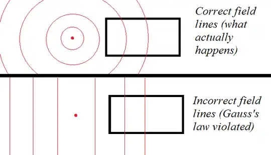

Let's draw a box that intersects the boundary of this wavefront. One end of the box will be have electric field vectors with magnitude $\propto r_{old}^{-2}$, while the other end will be $\propto r_{new}^{-2}$. These are not equal, so $\nabla \cdot E \neq 0$. But since there's no charge in the box, this should be impossible according to Gauss's law!
This analysis doesn't take into account that the electric field vectors are also changing along the sides of the box.
Gauss's law would only be violated if the point charge was sending out electric field vectors that were parallel to the sides of the box, in which case OP would be correct, we could just reduce the total flux through the box surface to (far end flux) - (near end flux). But the electric field vectors actually extend radially outward from the point charge, so there will be nonzero flux through every side of the box, not just the far end and the near end. The net flux through all sides of the box remains zero when the charge is shifted as a result.
Here's a picture of the difference. The electric field vectors are perpendicular to the electric potential lines shown in the picture.
