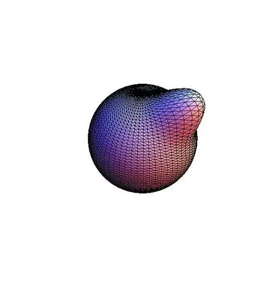

  2. Their Wigner function is localized on the sphere, as for instance the WF of this coherent state with $J=9$ rotated about $\hat y$ by $\beta=2\pi/9$: enter image description here
