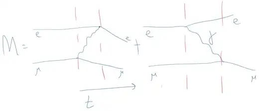

The graphical representation of the matrix element within the old-fashioned perturbation theory is shown below using $e-\mu$ scattering as an example. enter image description here
We have here two diagrams, each corresponding to different intermediate states (the state between the vertical red lines). In the first case, the muon emits a photon which is later absorbed by the electron. In the second case, the situation is the opposite.

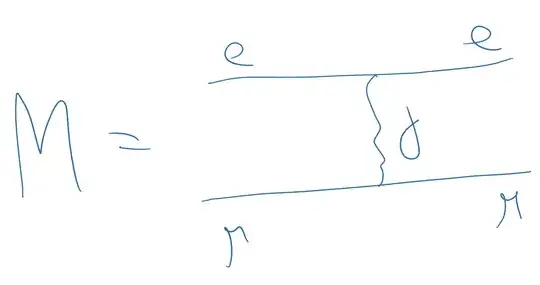

  1. When we are talking about relativistic processes, it is possible to re-interpret the old-fashioned perturbation theory in explicitly Lorentz-covariant fashion, where time is no longer dedicate quantity. After some manipulations, the matrix elements can be given in the form enter image description here where the photon line now corresponds to some object which has nothing to do with the physical photon - the propagator $D_{\mu\nu}$. Unlike the field operator of a free photon, which satisfies the Maxwell equation $$ \partial^{2}A_{\mu} = 0, $$ the propagator satisfies completely different equation (here I neglect some technical moments) $$ \partial^{2}_{x}D_{\mu\nu}(x-y) \sim g_{\mu\nu}\delta(x-y) $$
