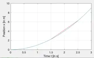

The mass density $\rho(x)$, and power $P(t)$ are defined as derivatives. This is analog to the (one-dimensional) velocity, $v = dx/dt$. At first glance it does not make sense to define the velocity as a derivative, but seams to be more intuitive to define it as the ratio of finite differences, $\Delta x/\Delta t$. However, one we think of each quantity as a function the derivative definition becomes clearer.
So let's consider a particular case $x(t) = t^2$ and ask: "What is the velocity at time $t_1=2s$?" Taking the concept of finite difference, we could e.g. take the position at times $t_0=1.5s$ and $t_2=2.5s$ and calculate $v(t_1) \approx \frac{x(t_2)-x(t_0)}{t_2 - t_1}$. However, plotting the position as a function of time in blue, and the calculated velocity in red, we see that the result is not perfect,
velo1
Hence, it seams natural to reduce the time difference $\Delta t = t_2 - t_1$. Doing so, we will observe that the red line approaches "the local shape" of the blue line closer and closer. In the limit $\Delta t \to 0$, which is merely the derivative, we obtain the closest match.
