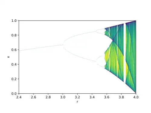

Thanks to @EricDuminil - he gave another more simple idea how to see chaotic behavior of systems. One just needs to recursively calculate Logistic map equation for couple of hundreds iteration:
$$ x_{n+1}=r\,x_{n}\left(1-x_{n}\right) $$
And draw $x$ values visited over all iterations as a function of bifurcation parameter $r$. One then will get a bifurcation diagram like this:
We can see that $r$ values in range $[2.4; 3.0]$ make a stable system, because it visits just 1 point. And when the bifurcation parameter is $r > 3.0$ the system becomes chaotic, output becomes unpredictable.
