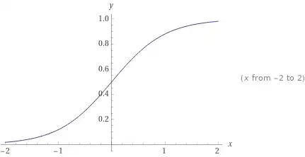

An alternative is the logistic sigmoid. $$T(x) = \frac{1}{1 + \exp(-2x/t)}$$ where $t$ has a similar definition. The plot below shows this function for $t=1$.
logic sigmoid
