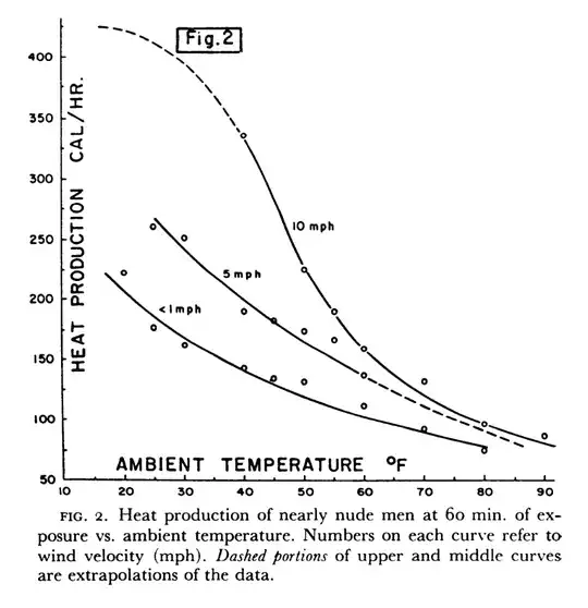

Your body generates heat at all times via your metabolism as well as internal friction. If you are relaxing in comfortable conditions, you are producing roughly 100 W - but this number increases if you start to exercise. In particular, when your body gets cold your brain activates the shiver reflex, which can cause your body's power output to jump to 200-300 W.
Heat Production from Shivering
Source (Note that $1 \text{ Cal/hr} \approx 1 \text{ W}$).

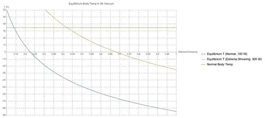

Ignoring for a moment the effect of clothing, then your equilibrium body temperature can be roughly estimated by equating the power generated by your metabolic processes (and possibly movement) with the power loss via radiation, assuming that you are not absorbing radiation from anywhere else. I am assuming that the body is at a uniform temperature here. This would not be the case - the core of your body would be warmest and then a gradient would form to your skin - but this can be neglected because the gradient would not be very extreme.
In this simplified model, this is the resulting equilibrium body temperature as a function of emissivity, assuming first 100 W and then 300 W of generated power.
Equilibrium Body Temp
As you can see, the situation is rather bleak if you're facing the void in the nude. Your core temperature can't drop much below its normal 37 C before you enter a hypothermic state; even shivering ferociously, this requires an emissivity of something like $0.425$, far below your body's typical value of $0.95$.

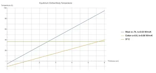

This is where clothing comes in. Textiles have a somewhat lower emissivity than naked humans do. The surface emissivity of wool is about 0.74, and most textiles are in that range or higher, which means that the surface of the garment would still equilibriate below 0 C.
However, the thermal conductivity of wool is only about $0.03\frac{\text{W}}{\text{m K}}$. For a garment of thickness $t$ covering your entire body, the temperature gradient from your body's surface to the surface of the garment would be
$$\frac{\Delta T}{t} = - \frac{100\text{ W}}{2\text{ m}^2 \cdot 0.03 \text{W/mK}} \approx 1670 \frac{\text{K}}{\text m}$$
Starting from the temperature of the garment's exterior, this allows us to track back and find the corresponding body temperature as a function of thickness. I've performed the calculation for wool and for cotton, with the results shown below.
Clothed Body Temp
The surface of a wool sweater would equilibriate at approximately -5 C, which would correspond to a 37 C body temperature if the thickness of the sweater were only about 3 cm. That's thick, certainly, but not absurdly so. For a cotton sweater, which would have both higher emissivity and higher thermal conductivity, the surface would equilibriate around -10 C and you would need a thickness of closer to 6 cm to keep you warm.
