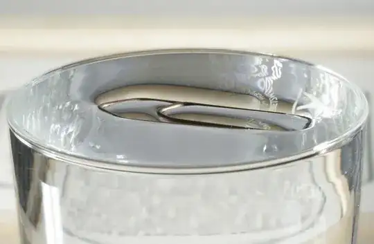

We know that a metal paper clip floats on water when it is carefully placed over the surface. This is attributed to the phenomenon of surface tension. I understand that, due to its weight it creates a depression in the fluid as seen in the image below:
Image source: Wikipedia

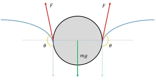

Due to this depression, there exists a vertical component of the otherwise horizontal force which supports the weight of the paper clip and ensures it stays on the surface. This is similar to placing a metal ball on a flexible rubber sheet. The following diagram shows a cross section of the paper clip and the forces acting on it:
Image source: My own work :)
I've learnt that the angle between the tangent planes at the solid surface and the liquid surface at the point of contact, is defined as the contact angle. Here it's $\theta$ and is obtuse. However, I've seen from different sources that metal-water contact angle is acute even in the presence of some surface contaminants, totally opposite to what is expected if it needs to be on top of water. The following statement is one such example:

Even though the above quote is for metals like copper and nickel, I think, even aluminium and iron (of which paper clips are made of) show a similar behaviour. If so, why does a metal paper clip float on top of water? Shouldn't it simply sink if there were no surface tension? Or is the obtuse contact angle (observed) related to the difference in contact angle near the top of a capillary tube of insufficient length?
Since we observe obtuse contact angle for an interface which ought to have an acute contact angle, will the result be same if we consider the other case? Or in other words, will a paper clip made of an ultrahydrophobic material (contact angle $>150^\circ$) float when placed on water?

When there is no wetting, the contact angle is obtuse. When wetting takes place, the contact angle becomes acute. A certain amount of pressure is needed to break the surface of the liquid so that wetting takes place. If wetting were to take place, the paperclip would sink (likewise it would sink if there were no surface tension).
When wetting does not take place, the contact angle is obtuse. The paper clip can float because wetting does not take place (or only a small amount of wetting takes place) - the clip is light enough that does not push hard enough on the surface of the water to break surface tension. This is undoubtedly helped by contaminants, such as oils picked up from fingers (it is opposite to capillary action, in which wetting does take place).
