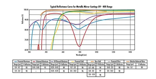

The thing is that there are no really good mirror coatings. From this plot from Edmund Optics, a reseller for technical optics, you can see that for 1-1.5 µm (telecommunication wavelength) the reflectance doesn't go higher than 98% (that's normal incidence, it will be a little higher for grazing incidence).
Reflectance Data

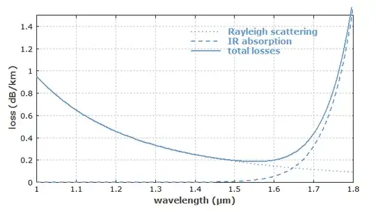

In contrast, the inner surface of a glass fiber with a clean surface has 100% reflectance. It's also important to note that the transmission within fused quartz fibers of 1-1.5 µm is particularly high, so there are very little transmission losses either, as can be seen in this plot (theoretical model) from RP Photonics:
Silica Fiber Transmission
