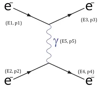

For the specific case of the following Feynman diagram, I was given the argument that the energy and momentum of the photon are over-constrained, hence the photon violates one constraint ie. the energy-momentum relation.
Electron Scattering Feynman diagram
However I fail to see why this is the case. This is my understanding: $E_1$, $E_2$, $p_1$, and $p_2$ are known as they are experimental parameters, so this leaves 6 unknowns (energy and momentum of the final states and of the photon). If I assume all of them follow the energy-momentum relation then this is reduced to 3 unknowns. Energy is conserved in each vertex which gives the relation between the remaining unknowns leaving 1 degree of freedom.
Is there any constraint I am missing? The only other reason I can think of is that the energies of the two final electrons are experimentally found not to depend on each other, meaning that this requires 2 degrees of freedom instead of one. Is this maybe the case?
Energy and momentum are conserved on internal lines, which means that the mass shell condition cannot hold (as you can establish with a simple calculation). $$ m^2\ne p^2 = E^2 - \mathbf p^2$$ The question of whether internal lines represent "virtual" particles is primarily philosophical. Feynman for one regarded them as real particles which are not directly observed.
