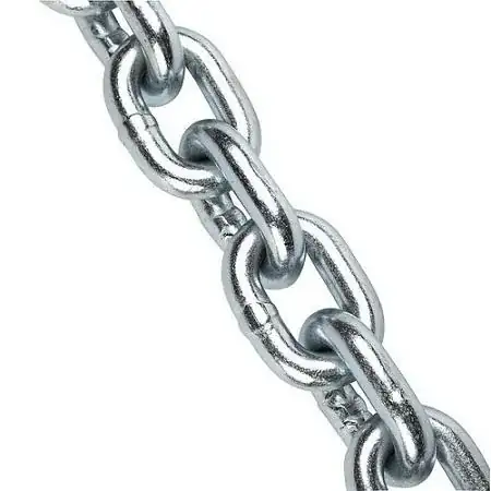

Although the following answers revolves around chains, however, the same physics can even be applied to ropes, since ropes itself is made up of thousands of such tiny chains. Therefore, the object under consideration is unimportant here, what is more important is the nature of collisions taking place.
Summary
The reason why the energy approach doesn't work is because there are inelastic collisions between the chain's loops going on.
What should happen if the collisions were elastic
Image source
Now to understand this, imagine pulling the chain up. Now let's analyze the lowest loop of the chain which was rising up with a velocity of $v$. The next loop after this loop has not been give a velocity yet. But as this loop moves up, the next loop also gains a velocit $v$. However, if we were to compare this case with an elastic collision, then we should expect the velocities of the chains to be exchanged (since they have the same mass). So what you'd expect is that the chain initially rising up, will come to rest after the collision and the chain which was on the ground would start rising up with a velocity $v$.
What really happens
However, this is not at all the case. In reality, when the lower loop collides with the rising loop, booth the loops start moving at the same velocity. But, this is precisely the characteristic of an inelastic collision, which implies that the collision in the chain case is inelastic.
Energy loss and the factor of 2
As you'd know, energy losses are bound to happen in inelastic collisions. And in this case, we have a case of a body moving with velocity $v$ colliding inelastically with a body (of the same mass) at rest. In this particular type of case, we can compute the difference between the initial and final energies and that difference will always be equal to half the initial energy. This implies that half the energy gets lost/dissipated. That's what's happening in your cas as well and thus you are getting an unwanted factor of $2$ while comparing both the approaches. Thus you do double the work to increase the kinetic energy ($\mu v^2 l$), but only half of that work is manifested as an increase in kinetic energy ($0.5 \mu v^2 l$).
Conclusion
So there isn't any specific force responsible for this discrepancy. It is due to dissipative nature of inelastic collisions. The lost energy would be converted to heat and sound energy, and the temperature of the chain will rise and you might hear the clanking sound of the chain.
