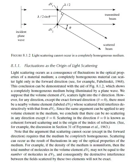

This absorption of energy and re-emission is called Rayleigh scattering, and the re-emitted photon can be emitted in any random direction (with the probability distribution following the antenna radiation distribution). However, because this happens in multiple atoms, the waves constructively interfere only in the forward direction, and destructively interfere in any other direction. This is explained wonderfully by Boyd in his nonlinear optics book:
Boyd
