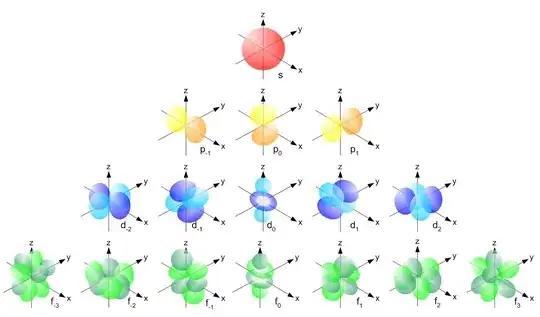

according to bohrs atomic model, the orbits of electrons are quantized and cant have an arbitrary radius, the electron revolving around the nucleus in this orbit, but when I was taught the quantum mechanical model of the atom we were introduced to the concept of orbitals $(s,p,d,f)$ which had different shapes like a sphere, dumbell, double dumbell, and triple dumbell I am unable to comprehend how an electron revolves around the nuclei in these orbits(if it even does because many a time I have been conveniently told that it's merely a cloud of probability of finding an electron and if it is so how does it satisfy $mvr = n\frac{h}{2\pi}$.)

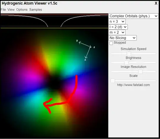

Now what do these orbitals have to do with angular momentum? Your picture shows what's called the real representation of the atomic orbitals$^\dagger$. The real representation is the easiest to sketch so this is why it's the most common. In the complex representation it's easier to see how the quantum numbers are related to angular momentum. I highly recommend this applet to see the orbitals simulated. If you pick the complex representation and a state with $m>0$ you get a picture like this.
The rainbow colors rotate clockwise. The colors represent the phase$^\dagger$ of the wavefunction. A phase that rotates in space roughly corresponds to momentum. For example a wave that moves to the right would look like this:
So you can kind of see that orbital with $m>0$ kind of looks like something with momentum that rotates in a ring. But to prevent oversimplification I have to stress that the probability density is constant in time for all these orbitals. They aren't moving. They are static distributions of the electron.
