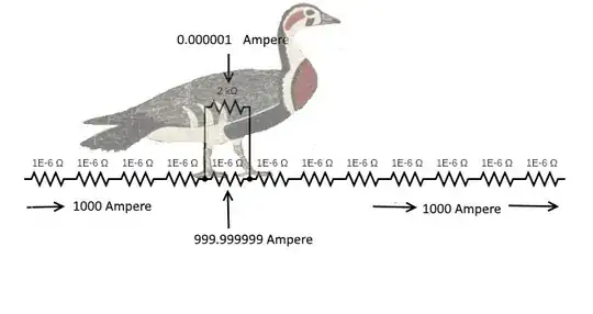

Let me say in advance: You are perfectly right! The wire is a resistor, the bird is a resistor, and a bird standing on a wire with both feet down is indeed a parallel resistor to the wire. This means indeed that current flows through the bird. It is just not much, because the wire is — by design! — a very bad resistor, and birdie is by comparison (and that is what counts here) a good enough resistor that not much current flows through it.
Here is a take with real numbers.
An overhead power line which can carry 1000 ampere has, according to this catalogue, p. 136, a specific resistance of $0.022\ \mathrm{\Omega/km}$, or $2.2\times10^{-2}\ \mathrm{\Omega/km}$. A ten centimeter stretch — assuming that the bird straddles this convenient distance — has therefore a resistance of $1/10\,000$ of that, or $2.2\times10^{-6}\ \mathrm\Omega$.
To push a current of 1000 ampere through the resistance of the straddled $10\ \mathrm{cm}$ stretch, $2.2\times10^{-6}\ \mathrm\Omega$, a potential difference of $$V=I\cdot R=1000\ \mathrm A\times2.2\times10^{-6}\ \mathrm\Omega=2.2\times10^{-3}\ \mathrm V$$ is needed. That is the potential difference between birdie's legs, a bit more than 2 millivolt. We could stop right here because we know that we can bridge a thousand times that potential difference without feeling anything, but let's for the fun continue. Last not least I have drawn a picture which I want to show.
According to research done with the goal of being nice to our dinner, a chicken's legs have a resistance of $1400\ \mathrm\Omega$ each. Because our bird is a little smaller, we assume only $2000\ \mathrm\Omega$ for both, also ignoring the resistance of the body between the legs, if only out of modesty.
This implies that the current flowing through birdie is $$I=V/R=2.2\times10^{-3}\ \mathrm V/2000\ \mathrm\Omega=1.1\times10^{-6}\ \mathrm A.$$ (Draining a AA battery with that current would take a hundred years or more.) The quoted chicken research paper also mentions that a stunning current of $81\ \mathrm{mA}$ is unreliable; that is $80\,000$ times the current flowing through birdie on the wire, so there is room for error, acid rain or voltage spikes.
Here is a circuit diagram depicting your parallel, unroasted bird. As you can see, I have drawn the wire as a sequence of adjacent resistors, each with a length of $10\ \mathrm{cm}$. Normal circuit diagrams simply ignore the micro-ohms and draw a straight wire. Shame on them! Guys, that confuses people! Every wire is a resistor! True, each $10\ \mathrm{cm}$ segment by itself is a very weak resistor; but a million of them are annoying enough that the power plant must up the ante to many kilovolt.
Non-roasted bird on a wire
I should perhaps add that we could reach the same conclusion easier. The voltage calculation is quite unnecessary if we assume that the bird does not change the overall current through the wire, before and after. Then the current (whatever voltage is driving it) simply splits according to the ratio of the resistances, which is about $10^9$, so that $1/10^9$th of the $1000\ \mathrm A$ going through the wire is going through the bird, which is $10^{-6}\ \mathrm A.$

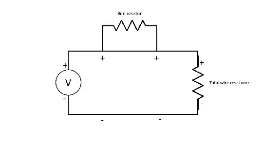

The size of the voltage in the wire is not what determines the current through the bird. It is the difference in the voltage between the bird's feet. If the wire is connected to a 600V source, the voltage between the birds legs is not 600V. The actual voltage difference is very small. The birds legs are touching two points very close to each other on the wire. The 600V drop is over the entire length of the wire from the power source back to the power source. The bird would have to be touch parts of the wire miles apart in order to feel any significant amount of voltage. The electrical wire is also a good conductor, which means its resistance is small and so the voltage drops only a small amount over any distance that a single animal could reach.
To be more concrete, say you hook up a 9V battery to a light bulb with two wires. The wire connected to the positive terminal will be at a voltage of 9V. The entire wire will have a voltage of 9V. This means that, if you connect a pair of voltmeter probes to the same wire, you will measure a potential difference of zero, because both probes will be measuring the same potential. It is only when the probes are in contact with different wires that you will measure the 9V difference.
Remember, it is differences in voltage that cause current, not just an amount of voltage. I can be perfectly safe standing in a 600-foot tower. I am only in danger if I fall from that tower and hit the ground 600 feet below. If the bird on the wire could somehow reach the ground or another wire at a different voltage at the same time, then it would feel the full 600V potential difference, because two parts of its body would be feeling different voltages, which would cause a current to flow.
Your parallel circuit works because the first resistor causes a large drop in electrical potential from one side to the other. So, when you connect a second resistor in parallel, there is a potential difference across the second resistor. The bird on a wire is more akin to this diagram:
Resistance diagram with bird
The pluses indicate the constant higher voltage on the top wire and the negatives indicate the constant lower voltage on the bottom wire. It is only when a resistor straddles a positive-negative difference that a current flows through it. The bird resistor at top, with its legs touching parts of the wire with identical voltages, will have no current flowing through it. All of the current will flow through the much lower resistance wire.
The bird will have a resistance of, say, 1 M$\Omega$, while the wire between the birds feet will have a resistance of, say, 0.1 $\Omega$. Calculate the amount of current that will flow in the 1M$\Omega$ resistor in a parallel configuration.

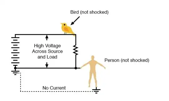

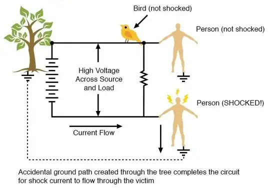

What is true for birds equally applies to humans: you can touch a wire carrying a significant current, and you won't get shocked unless there is a voltage difference between you and the wire:
Note that voltage itself doesn't matter. In case of a ground fault, it may well happen that the "live" (high voltage) wire becomes safe to touch:
Pictures are taken from the article about shock current path
Birds don't actually have much higher resistance than humans and they also get shocked just as well when they manage to complete the circuit for the shock current to pass.
