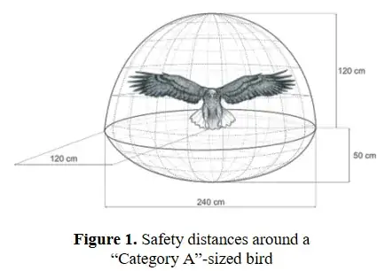

Engineers who design high voltage power lines are well aware of the problems that birds may cause both to the bird itself and to the power line which would temporarily trip if the air around the cables becomes conducting to a significant degree.
Here is a diagram of the sort of size parameters which engineers use when designing power lines.
The paper Bird protection on medium voltage power lines gives an indication care taken to avoid harm to birds during the design process.
