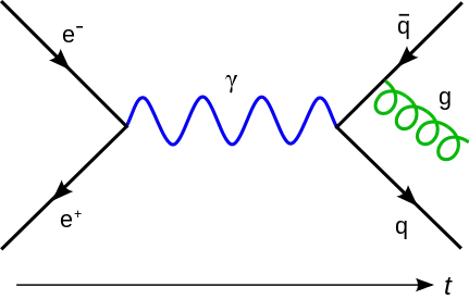

The Feynman diagram is a tool to represent quark, lepton, boson, meson or baryon reactions. Below, the transformation of a positron $e^{+}$ (lepton) and an electron $e^-$ (lepton) into a photon $\gamma$ (boson). Then the photon transforms back into "any" pair quark-antiquark with the emission of a gluon.

How do you place bosons (photons and gluons) when you only know the undetailed reaction? I assume it is with the conservation of numbers (other rules), but what is the detailed method on the example provided here? In the reaction $e^+ + e^- \rightarrow q + \bar{q}$, how do you know you must write a photon in between? And how do you know the gluon is emitted? Do you have to learn them by heart? Here I just picked an "easy" example because I don't understand the thought process and I would like to replicate try to replicate it by myself on a bigger reaction like the reaction of baryons without having to look up online what the reaction is.

The diagram you write down is a bona-fide Feynman diagram (mostly) describing $e^+e^-$ annihilation at high energies, and has a formal expression in perturbation theory to summarize, which gives you the leading order of the process. It involves a photon, because this is the strongest interaction the lepton pair can undergo. More photons would be suppressed by powers of α. Photons couple to leptons, so the outcome could have been a $\tau^+ \tau^-$, for instance, but also to quarks, so your picture has it produce a quark-antiquark pair, of a given flavor. Unfortunately, the quarks won't stay like that, but will "dress" themselves to hadrons by the emission of zillions, not just one, of gluons and quark-antiquark pairs, virtually pointless to write Feynman diagrams for, since they won't correspond to meaningful terms in a useful perturbation expansion, the strong coupling being large there.
