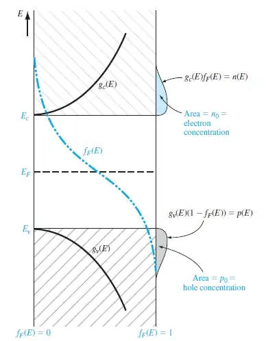

But It still didn't clear my doubt.Consider the following figure enter image description here
As you can see the fermi energy (Fermi energy)
lies in between the bandgap and figure shows the Fermi-dirac distribution.At Fermi energy there is $50 \%$ that the state is occupied by an electron but it's a forbidden region and it is sure that no electron can attain this energy state,then why there is a finite probability that electron will occupy these states? Please correct me if I some where mistaken.

This is not quite right. The correct statement is that the probability that a state with energy $E=\mu$ is occupied is 50%. There is no reason to think, however, that there exists such a state in the first place.

All of this analysis has occurred without specifying either $\epsilon$ or $\mu$. If the excited state has $\epsilon=\mu$, then the probability that it would be occupied would indeed be $\frac{1}{2}$, but why on Earth should that be the case?
The key takeaway from this is that, given some fixed chemical potential $\mu$ and temperature $T$, the probability that an energy level (in a system of non-interacting particles) is occupied is exclusively a function of the level's energy, and in particular does not depend on which energy levels actually exist in the first place. Different systems have different allowed energy levels, and there is no reason whatsoever to think that one of them would happen to coincide with $\mu$.

Let's Begin with Introducing energy state: Energy state: s orbital has two energy states with same energy. P has 6 energy states with same energy.
Now Fermi Dirac fxn gives you the probability of finding filled energy states at given Energy value provided there exists available energy states at that energy value.
Not Only at Fermi Level, The Femi Distribution fxn gives values b/w 0-1 at every Energy Values b/w Ev and Ec which lie in forbidden gap, as well!
Your Problem is In forbidden gap there exists no available energy states hence no electrons! But at certain energy b/w Ev and Ec, Fermi fxn still gives a no. say 0.1
Now, 0.1 here says that if there had been energy states available for electron then there were 1% probability of finding filled energy state. Finding a filled energy state is equivalent to finding electron. Hence if there had been energy state available for electrons then there was 0.1 probability of finding electron at this energy value lying in forbidden gap.
This behavior is beautifully controlled by density of states fxn. which ensures there is no Available energy state present b/w Energy values Ec and Ev.
Yet, We have traps in crystal structures which manifests themselves in Energy Band Diagram as Trap Energy States. These Trap Energy States may have Energy Values lying-in forbidden gap. The Probability of finding electron in forbidden gap becomes real and guess what Fermi distribution fxn gives that probability. (as we have energy state present)
