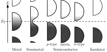

Now what does it mean when the Fermi level lies in the band gap or instead in one of the bands? Here's an overview using a nice diagram from wikipedia:
The y-axis is the energy and x-axis the density of states(of electrons) available for different band structures of different materials.
  • Metals: are very good conductors because the Fermi level lies inside one of the bands, meaning there's no energy gap to overcome for an electron in the valence band to pass on to the conduction band. Which explains why metals are populated by quasi-free electrons in the conduction band.
  • Semi-metals: Very similarly to metals, $E_F$ lies in one of the bands, but unlike metals, here the overlap between valence and conduction bands are very small. But still no gap!
  • Semiconductors: For semiconductors, there's a small energy gap between the two valence and conduction bands, the states in the gap are not available to the electrons. So in order to have moving charge carriers, electrons and holes, the system first has to be heated up (excited, also possible with an applied E-field) in order to overcome the gap $E_g$ and be able to occupy the available states in the conduction band. Now because for semiconductors the gap is usually very narrow, about $\leq 4 eV$, meaning it requires a specific minimum amount of energy for the transition. Because this gap is so small, the properties of semiconductors lies between those of conductors and insulators, but unlike metals, semiconductors increase their conductivity with temperature, because the overlap between the two bands becomes greater with increasing T. Finally as you see in the above diagram, $E_F$ lies in the gap for semiconductors, which means occupied and unoccupied states in valence and conduction band respectively are energetically separated. The neat thing about semiconductors is that they can be n and p doped, which respectively causes the fermi level to shift towards the conduction band and the valence band.
  • Finally for insulators, the energy gap between the two bands in so large, that it becomes very difficult to excite electrons towards the conduction band, hence their poor conductivity.
A final point: one may ask where do these gaps come from anyway? For solids, when you take the nearly free electron model and add a periodic potential $V(\mathbf{r+R})=V(\mathbf{r})$ to the picture ($\mathbf{R}$ the lattice vector), and solve the Schroedinger equation using degenerate perturbation theory, we see that a gap opens up between the energy eigenvalues at the zone boundary in momentum space $\mathbf{k}$, i.e. $$E_{\pm}=\epsilon_0(\mathbf{k})\pm |V_G|$$
$V_G$ being the value of added periodic potential at zone boundary. In conclusion when electrons are subject to a periodic potential, gaps arise in their dispersion relation. Thus the electron spectrum breaks into bands, with a forbidden energy gap between the two bands.
