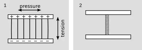

In figure 1, there is pressure trying to make the capacitor plates explode laterally, and also tension trying to make them collapse together against each other. From the assumptions above, one can show that in this example, in the rest frame of the capacitor, the electromagnetic field's stress-energy tensor has components $T_{(em)}^{tt}=(1/8\pi k)E^2$ (energy density) and $T_{(em)}^{yy}=-(1/8\pi k)E^2$ (tension in the $y$ direction, parallel to the field). It's easy to see that this has a nonvanishing four-divergence, since $\partial T_{(em)}^{yy}/\partial y\ne0$ at the plates, and there are no other terms in the stress-energy tensor that could compensate for this.
There is nothing surprising here; only the total stress-energy tensor $T$ has to be divergenceless, not $T_{(em)}$. It would violate the laws of physics if the capacitor were to remain in equilibrium like this without some force to counter the electromagnetic tension. Let's say that this force is provided by a spring, as in figure 2. The spring has its own contribution $T_{(s)}$ to the stress-energy. For convenience, let's imagine making the spring filled in (rather than a hollow cylinder) and fattening it up so that it fills the entire interior volume of the capacitor. Then to achieve static equilibrium in the rest frame, we need the pressure in the spring to cancel out the pressure in the electric field. We therefore have $T^{yy}=0$ for the total stress-energy tensor.
If we now apply the tensor transformation law to the stress-energy tensor, we find that the stress-energy tensor in the boosted frame contains a mass-energy density $T^{t't'}$ that depends only on $T^{tt}$ and $T^{yy}$. (There also has to be an xx component to keep the plates from exploding laterally, but that doesn't enter here.) But we have $T^{yy}=0$, so the problem is exactly the same as transforming a lump of nonrelativistic matter, and we know that that calculation comes out OK.
[Rindler 1988] shows that this still works out if we drop the simplifying assumption that the spring fills the entire interior volume of the capacitor.

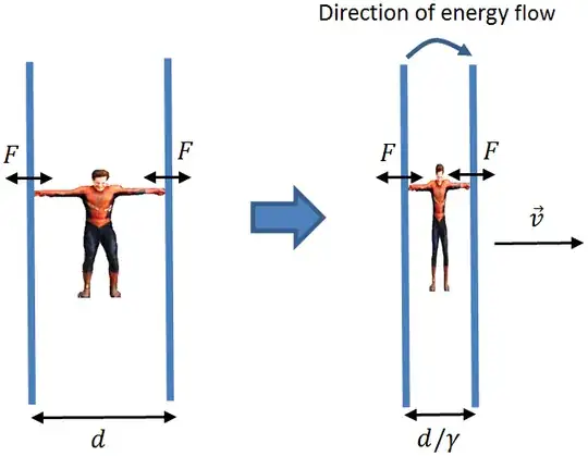

I also came up with this problem a month ago and wrote a post in my blog. But I resolved it in a much different way than any other answers posted here. I'm still not quite sure about my argument here but it seems plausible and interesting to me.
The total field energy in the capacitor's rest frame is
$U=\int \frac{\epsilon_0}{2}E^2dV=\frac{\epsilon_0E^2Ad}{2} $
Now an important point to note is that the capacitor plates are attracting one another, and they cannot simply stay there without crashing into each other. So let's say there's a rigid massless rod between the plates to hold the plates in place.
In the capacitor's rest frame, we can calculate the magnitude forces acting on left and right plates.
$F=\int (\frac{E}{2})\sigma dA=\frac{\epsilon_0 E^2 A}{2}$
In this frame obviously these forces do not provide any work. However in the primed frame, the rod plays a role as an energy transmitter. I mean, first imagine that there is no rod between the plates. Since the plates are attracting each other, the right plate will slow down and the left plate will speed up. Now if there is a rigid rod between them, their velocities will not change at all. In other words, the rod is taking energy from the left plate at a rate $F.v$ and transfer it into the right plate to account for the attraction. But, remember that the energy can’t teleport from one plate to the other plate instantaneously. Thus perhaps some of it has not reach the right plate yet, and still located between the plates. Or we can also say that the rod's mass is increased.
In the capacitor's rest frame, we can safely say that the event $1$ “force start acting on the left plate” and event $2$ “force start acting on the right plate” must happen simultaneously due to symmetry.
However, in the primed frame there's a loss of simultaneity. Event $1$ happens $\Delta t=\gamma \frac{vd}{c^2}$ seconds before event $2$. During this time, the rod steals an amount of energy $\Delta U$ from the left plate without paying any energy to the right plate.
$\Delta U=F.v \Delta t=\frac{\gamma \epsilon_0 E^2 Ad}{2} \frac{v^2}{c^2}$
if we take into account this "hidden energy" to the total energy in the primed frame
$U'=U/\gamma+\Delta U=\frac{\epsilon_0E^2Ad}{2\gamma}+\frac{\gamma \epsilon_0 E^2 Ad}{2} \frac{v^2}{c^2}$
$U'=\frac{\gamma\epsilon_0E^2Ad}{2}=\gamma U$
