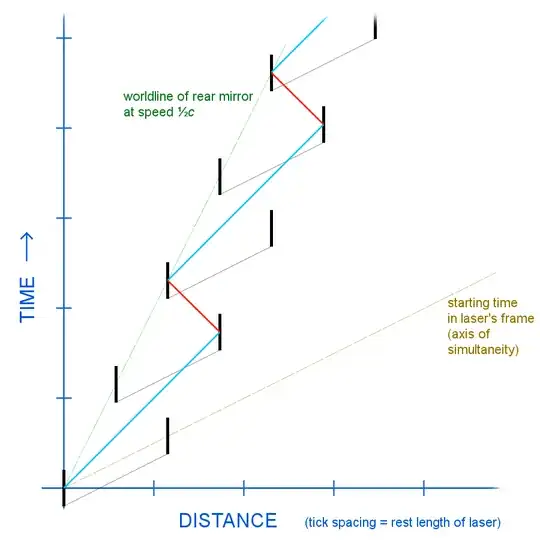

So I modeled a simple resonator, or laser, and looked at a small sample of light in it, which might be one photon. In its rest frame the laser has length $d$, and the light sample has frequency $f$, wavelength $\lambda$, and energy $E$. So when moving the forward-going light will have frequency $f/R$ and wavelength $\lambda R$, and vice versa for the reverse-moving light. And energy is proportional to frequency. And I thought, if we average the forward momentum with the backward momentum we should get the total, and likewise for energy. This led me to a pair of naive first-approximation formulas: for momentum, $\frac{1}{2}(\frac{1}{R} – R)E∕c$, and for energy, $\frac{1}{2}(\frac{1}{R} + R)E$. For a numeric example, consider $\beta=\frac{1}{2}$: in this case $R=\sqrt{\frac{1}{3}}$, and the blue-shifted forward light has three times the frequency of the red-shifted backward light. The resulting energy is $1.1547E$ and the momentum is $0.57735E/c$, which are correct. Then I did some algebra and verified that this momentum formula is indeed equivalent to $\gamma\beta E/c$ and the energy formula is equivalent to $\gamma E$. Problem solved, right?
Not so fast. I then noticed a problem. I'd been doing a simple average of forward and backward globs of light, giving them equal weight. But the light isn't weighted equally! It spends more time going forward than going backward. In the $\beta=\frac{1}{2}$ case, it spends three fourths of its time going forward and one fourth going backward. This means that at any given time, three fourths of the photons in the laser are going forward, and have blue-shifted energy rather than red-shifted energy.
Here, I made a spacetime diagram of it: enter image description here
Another way to look at it is that if the Doppler shift increases frequency by $R$, it increases power by $R^2$. The rate of photon reception per second goes up, as well as the energy in each photon. No matter how I look at it, I have to conclude that in this case, there is nine times as much energy and momentum in the forward-moving light as in the backward-moving light: three times as many photons with three times as much oomph apiece.
But this produces a completely wrong result when I try to compare the resulting mass or energy to what it should be. Like, instead of $1.1547E$ for the energy, I get $1.443E$. I got this by weighting the forward light by $(1+\beta)$ and the backward light by $(1-\beta)$ before averaging. And that is way too much, apparently violating conservation of energy.
Where have I gone wrong in my understanding?

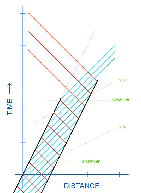

Update: In an earlier update which I've deleted, I said that I thought I was getting to an answer. I was wrong. I fooled myself and didn't notice I was subtly slipping back into the rest frame of reference.
During the time I thought my new approach was working, I made a new spacetime diagram, showing a more continuously operating resonator, which at some given time opens both its mirrors, dumping half of the light out of each end: enter image description here
This diagram confirms that at speed $\frac{1}{2}c$, photons or wavefronts moving to the right are three times as frequent in both space and time as those going to the left. (Though if you measure along the rest-frame diagonals everything is even.) This difference in photons per second is enough to completely account for all of the expected change of net energy in the system, without leaving any room for each photon to also have differing energy due to its changed frequency.

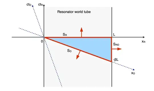

The following shows that the detailed balance resonator result also follows from stress-energy conservation.
Consider the world-tube of the resonator as traced in its own rest frame, and let us take a slice of this world-tube bounded by two constant-time hyperplanes (3D-spaces), $S_R$ for the resonator frame, $S_O$ for the observer frame, and the time-like sides of the world-tube. The observer moves at velocity $-\beta c$ in this view. The two hyperplane cut-outs lying within the world-tube correspond to the resonator as observed at the given times in the two frames. For convenience, and without lack of generality, let us choose the common time origin at the moment when the resonator's rear end passes the common space origin, and let the two hyperplanes correspond to $ct=0$ in both frames. The world-tube slice is then simplified to a wedge, as in the figure.
For this arrangement, stress-energy conservation implies that the total resonator 4-momentum on the observer $S_O$ hyperplane must be (the Lorentz transform of) the sum of the total 4-momentum on $S_R$ plus the contribution of the side time-like hypersurface $S_{RO}$ with outward normal, in the positive x-direction (caution: directions of normals follow the switch $-S_O + S_R + S_{RO} = 0 \rightarrow S_O = S_R + S_{RO}$). The latter lies between proper times $ct_1=0$ and $ct_2$ corresponding to the front end of the resonator at time $ct_O = 0$ in the observer frame, that is at $ct_O = 0 = \gamma(ct_2+\beta L)$, or $ct_2 = -\beta L$. Indeed, the $S_R + S_{RO}$ contributions amount to $$ \tau^\mu = \int_0^L{dx \left( \bf{e}_{t} \cdot T \right)^\mu } + \int_{-\beta L}^0{ \left( \bf{e}_x \cdot T \right)^\mu} = \int_0^L{dx\; T^{\mu 0}} + \int_{-\beta L}^0{dt \; T^{\mu 1}} = L T^{\mu 0} + \beta L T^{\mu 1} $$ Their Lorentz boost to the observer frame gives, for $T^{01} = T^{10} = 0$, $T^{00} = T^{11} = 2n_0\hbar\omega_0 = 2e_0$, $$ E = \gamma(\tau^0 + \beta \tau^1) = \gamma\left[ (L T^{00} + \beta L T^{01}) + \beta \left( L T^{10} + \beta L T^{11} \right) \right] = \gamma \left( L T^{00} + \beta^2 L T^{11} \right) = 2 \gamma (1 + \beta^2)E_0 $$ $$ Pc = \gamma(\tau^1 + \beta \tau^0) = \gamma\left[ (L T^{10} + \beta L T^{11}) + \beta \left( L T^{00} + \beta L T^{01} \right) \right] = \gamma \left( \beta L T^{11} + \beta L T^{00} \right) = 2 \gamma \beta E_0 $$ These are precisely the same values as obtained before.
The really interesting thing is that what was identified previously as the radiation pressure contribution is now seen to arise entirely from the time-like $S_{RO}$ terms, and therefore appears as a dynamical effect. And although with the current choice of world-tube wedge these terms occur asymmetrically at the front mirror, shifting the $S_O$ hyperplane at another time shows that they represent a difference of contributions from both mirrors.

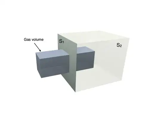

Now consider energy-momentum conservation in the 3D-volume enclosed by $S_1 \cup S_2$. Since we have a static system and the energy-momentum content does not change in time, the corresponding total fluxes through $S_1 \cup S_2$ must be null. But this implies that the gas stresses (pressures) plus the container wall stresses integrated on $S_1$ must be null too, because $S_2$ is outside the system and cannot contribute.
The null stress integrals on the otherwise arbitrary $S_1$ mean in turn null volume integrals for the local stresses of the gas plus container system. Again, this holds both in the container rest frame and in any boosted frame. In a boosted frame it further means that $$ \int_{\text{boosted resonator}}{dx \;\gamma^2(\rho_{\text{total}} c^2 + \beta^2 \Pi_{\text{total}})} = \int_{\text{boosted resonator}}{dx \;\gamma^2\rho_{\text{total}} c^2} = $$ $$ \int_{\text{rest resonator}}{\frac{dx_0}{\gamma}\; \gamma^2\rho_{\text{total}} c^2} = \gamma \int_{\text{rest resonator}}{dx_0 \;\rho_{\text{total}} c^2} $$ and similarly for total momentum, which is what we hope to see. Here $\rho_{\text{total}}$ and $\Pi_{\text{total}}$ are extended to denote gas mass density and pressure at points within the gas, and wall mass density and pressure within the walls, whereas $$ \int_{\text{boosted resonator}}{dx \;\Pi_{\text{total}} } = \left(\int_{\text{boosted gas}}{dx \;\Pi_{\text{gas}} } \right) + \left(\int_{\text{boosted resonator walls}}{dx \;\Pi_{\text{resonator walls}} }\right) = 0 $$ Note that the argument makes explicit use of the particle gas view. The same holds for the "dust", but the gas enables a smooth generalization to the photon case.
Alternatively, we can apply the 4-volume version of the conservation law as in Update 2 of my previous answer and find that at any point in time stresses in the resonator wall render null the gas contribution on the time-like surface $S_{RO}$.
In any case, the bottom line is that for the total energy $E$ and total momentum $P$ we have the usual relativistic conservation, $$ \left[ (E_\text{resonator + particle gas})^2 - (P_\text{resonator + particle gas})^2\right] \Big|_{\text{rest frame} } = $$ $$ \left[ (E_\text{resonator + particle gas})^2 - (P_\text{resonator + particle gas})^2\right] \Big|_{\text{boosted frame} } = $$ $$ \left[ (E_\text{resonator + photon gas})^2 - (P_\text{resonator + photon gas})^2\right] \Big|_{\text{rest frame} } = $$ $$ \left[ (E_\text{resonator + photon gas})^2 - (P_\text{resonator + photon gas})^2\right] \Big|_{\text{boosted frame} } $$ provided stress redistribution within the resonator is properly accounted for.
