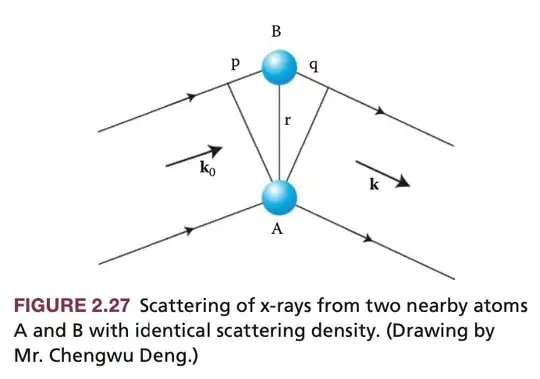

With reference to Figure 2.27, we assume two parallel plane x-ray waves of wavelength $\lambda$ and frequency $v$ (hence velocity $c = \lambda v$), scattered elastically from two nearby atoms $A$ and $B$ of identical scattering density. The wave vector for the incoming wave is $\mathbf{k}_0$ and that of the diffracted beam is $\mathbf{k}$. Because we assume elastic scattering:
$$|\mathbf{k}_0| = |\mathbf{k}| = k = 2\pi/\lambda \tag{2.31}$$
Scattering atom $A$ is at the origin, and scattering atom $B$ is at a distance $r$ away from the origin. The path difference, or phase factor, between the waves can be calculated from Figure 2.27 as:
$$p + q = \mathbf{r} \cdot (\mathbf{k} − \mathbf{k}_0) = \mathbf{r}\cdot \Delta \mathbf{k} \tag{2.32}$$

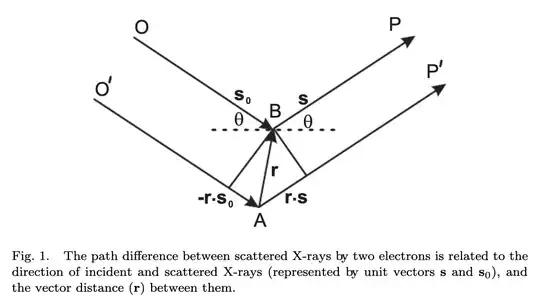

When the incident X-ray is scattered by two electrons separated by a vector $\mathbf{r}$ in space, in calculation of the combined scattered intensity the path length difference between the two scattered beams needs to be considered. According to Fig. 1, the path difference between the waves scattered on the two electrons is:
$$(O'AP' - OBP) = \mathbf{r} \cdot (\mathbf{s} - \mathbf{s}_0) \tag{2}$$
where $\mathbf{s}_0$ and $\mathbf{s}$ are the unit vectors of the incident and scattered X-rays. Hence, the phase difference is
$$\mathbf{r} \cdot (\mathbf{s} - \mathbf{s}_0) \cdot 2\pi / \lambda = \mathbf{r} \cdot \mathbf{q} \tag{3}$$
Here $\mathbf{q} = (\mathbf{s} - \mathbf{s}_0) \cdot 2\pi / \lambda$ is the wave vector of scattered light and $|\mathbf{q}| = 4\pi / \lambda \cdot \sin(\theta)$.

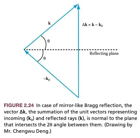

The magnitude of vector $\Delta \mathbf{k}$, from Figure 2.24, is then given as:
$$|\Delta \mathbf{k}| = 2 \mathbf{k} \sin(\theta) \tag{2.24}$$
This actually produces a calculation that agrees with that of the paper:
$$|\Delta \mathbf{k}| = 2k\sin(\theta) = 2(2 \pi / \lambda)\sin(\theta) = 4\pi / \lambda \cdot \sin(\theta)$$
However, my confusion is that it is still not clear to me what $p$ and $q$ are supposed to be in the textbook, and, therefore, what $p + q$ is?
I would greatly appreciate it if people would please take the time to clarify this.

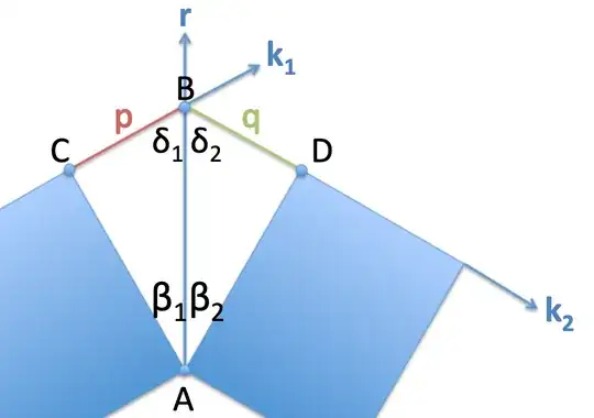

We need to calculate the phase difference between these two rays. Thus, as stated here we need to calculate $$ \frac{\Delta \phi}{2\pi} = \frac{\textrm{"distance beam 0"} - \textrm{"distance beam 1"}}{\lambda} = \frac{(p + q) - 0}{\lambda} $$ fig02 Instead of using the index "zero" and "no index" I prefer to use "1" and "2". I also included some angles and draw the direction of the used vectors explicitly -- I reckon this is the main problem you had. There is not enough space left, so I omitted the distance $r$. Please note, that $r = \overline{AB}$ is the distance between point $A$ and point $B$.
Now we do the math. From the triangle $A, B, C$ we obtain $p = r \sin{\beta_1} = r \cos{(\delta_1)}$. Similarly, we obtain $q = r \sin{\beta_2} = r \cos{(\delta_2)}$ from the triangle $A, B, D$.

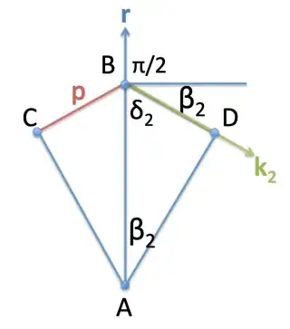

Next, we need to express the angles in terms of the wave vectors $\vec k_1$ and $\vec k_2$. In order to do so, we use the vector projection $$ \vec a \cdot \vec b = a b \, \cos{(\textrm{"angle between a and b"})} $$ So let's calculate the two projections. The first one is straight forward, $$ \vec r \cdot \vec k_1 = r k_1 \cos{(\delta_1)} \Rightarrow \cos{(\delta_1)} = \ldots $$ In the second one we need to consider the directions of the vectors, which yields $$ \vec r \cdot \vec k_2 = r k_2 \cos{(\pi/2 + \beta_2)} = - r k_2 \sin{(\beta_2)} = -r k_2 \cos{(\delta_2)} \Rightarrow \cos{(\delta_2)} = \ldots $$ fig03
where in the second step we use a trigonometric identity and in the last step we used the findings from above.
Last, let's put things together \begin{align} \frac{\Delta \phi}{2\pi} &= \frac{p + q}{\lambda} = \frac{p + q}{\lambda} = \frac{\frac{\vec r \cdot \vec k_2}{k_2} + \frac{-\vec r \cdot \vec k_1}{k_1}}{\lambda} \end{align} Finally, we use $k_1 = k_2 = k = 2\pi/\lambda$ and obtain $$ \frac{\Delta \phi}{2\pi} = \frac{p + q}{\lambda} = \frac{\vec r \cdot (\vec k_2- \vec k_1)}{2\pi}$$ Now drop the denominator on both sides.
So, to explicitly answer your question,
  • $p = \overline{CB}$ is the distance between point $B$ and $C$, and
  • $q = \overline{BD}$ is the distance between point $B$ and $D$.
