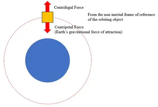

The phenomenon of weightlessness could be explained in two different ways:
  • The object orbiting the planet is in free fall (as described in other answers).
  • The centrifugal force counteracts the earth's gravitational force of attraction.
As the first point is explained by the other answers, I'd like to throw some light on the second point.
Centrifugal force is a type of inertial force (also called a "fictitious" or "pseudo" force) used in a non-inertial frame in order to apply Newton's laws of motion happily as we used to do in an inertial frame. Or in easier terms, you may consider it as some force which pushes you in the opposite direction when you make a sharp turn in your car.
Let us consider the following image:
In an orbiting satellite's reference frame the centrifugal force counteracts the centripetal force giving a resultant force of zero. Since there is no net force on the object everything in the object's reference frame remains at rest or in uniform motion. What happens when the object stops orbiting? Then it'll simply fall back to earth as there'll be no centrifugal force.
In order to understand why the quoted text is incorrect let's consider another example. Imagine a very tall (very very tall) tower from the equator. Inside the tower, at an altitude of $400 \mathrm{km}$ from the mean sea level (which is the average altitude of the International Space Station), will you feel weightlessness?
No. You'll be able to stand on the floor but the net force on you is not entirely due to gravity but also due to centrifugal force. This time the centrifugal force is due to earth's rotation about its axis.
