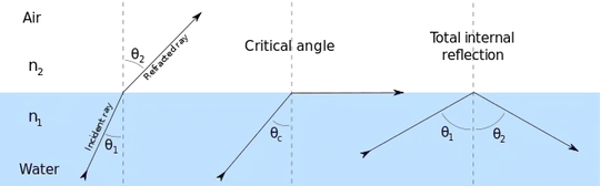

In particular, as regards time-reversibility, this diagram is hugely misleading:
Why is it misleading? Well, because it assumes that you can work in the ray approximation, and this fails when you're at the critical angle. All optics is wave optics, and that reduces to ray optics in many situations, but this isn't quite one of them.

This is also why the initial diagram is wrong: in proper plane-wave refraction at the critical angle, you don't have a single beam striking the boundary at a single place; instead, you have a plane wave inciding on the entire boundary at all times, interfacing with a (non-)evanescent wave on the other side. Thus, if you stop time and make it go backwards, the incident beam will turn into a plane wave that does not 'originate' from anywhere in the beam. (And, also: to really say that you've 'turned time backwards', you also need to supply the time-reversed version of the reflected beam, which supplies all of the energy flux that gets transferred to the time-reversed incident beam.)

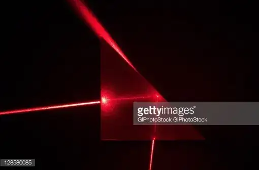

And finally, to come back to the question: what happens in a physical experiment, if you shine a beam at exactly the critical angle, i.e. something like this,
Image source: Getty, obviously. I couldn't find one without a watermark. If you do, please tell me.
and then you try and reverse time? Here the image makes it clear that the integral above is what's going on: if the center of the beam is at exactly the critical angle, then half of its energy is in modes at higher angles (which completely reflect internally), and half of its energy is at angles that are almost-but-not-quite at the critical angle, and these come away at a finite transmission angle away from $90$°. This must be the case: the only way to step away from that is to come in with a mode with an infinite transverse spread at the boundary; this is the wave version of the uncertainty principle at work.
And, if you want to time-reverse this, then you fall back into a linear combination of the two easier cases: you need to provide a beam at grazing-but-nonzero incidence from the transmission side, which has a well-defined incidence point, and everything is fine. (And, similarly, you also need to provide the time-reversed version of the reflected beam, and this is what will be putting in most of the energy into the time-reversed incident beam. If not, then you will get a reflection of the time-reversed transmitted beam, which is completely absent in the non-time-reversed version.)
