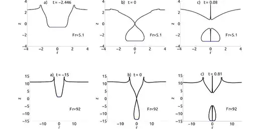

Also included is pre-print of the article Generation and Breakup of Worthington Jets After Cavity Collapse by S Gekle and J M Gordillo (2009), from which the following diagrams are taken. These show simulations of the formation of the jets, which are the spikes in the right-hand diagrams.
Gekle and Gordillo's paper develops a numerical model to identify how the formation and break up of the jet depend on the dimensionless Froude Number $Fr=V^2/gR$ and Weber Number $We=\rho R V^2/\sigma$ which characterise the experiment. They not give a complete analytical derivation of the relation between the jet ejection velocity $U$ and the radius $R$ and velocity of impact $V$ of the object (which is modelled as a circular disk) and the density $\rho$ and surface tension $\sigma$ of the liquid. When $U$ is known the maximum height of the splash is $U^2/2g$.
