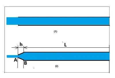

When using garden hoses, reduce the cross-section of the outlet area h (see Figure 2). Compared to when the outlet cross-section was not reduced (see Figure 1), the flow of water was obstructed. Therefore, the pressure in the pipe area L will increase, just like when flowing water collides with an object blocking the flow, the pressure will increase.
Meanwhile, due to the obstruction of flow, the speed will also decrease. The increase in pressure and the decrease in speed occur simultaneously because you have reduced the cross-section of the outlet area h.
Due to the increase in pressure, the pressure at the inlet B of the outlet area h also increases, resulting in an increase in the velocity of water in the outlet area h.

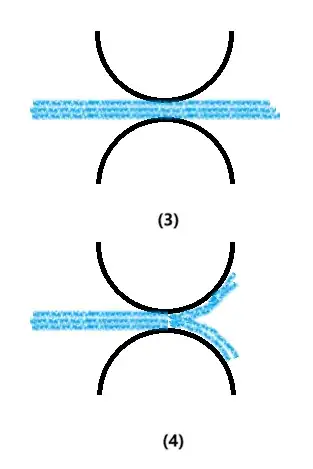

The phenomenon of paper sticking together. As shown in Figure 3, there are two curved paper strips (usually a curved surface because the strips are soft). When air blows between paper strips, it does not move in a straight line.
As shown in Figure 4, air will follow a curved path between the paper sheets, creating a low pressure on the back of the sheets, as indicated by the red curve. This low pressure causes the paper strips to stick together.
But once they are sucked together and no air flows through, the low pressure will disappear and the paper strips will separate from each other. Then, due to the flow of air and the generation of low pressure, the paper strips were sucked together again. Just keep cycling like this.
