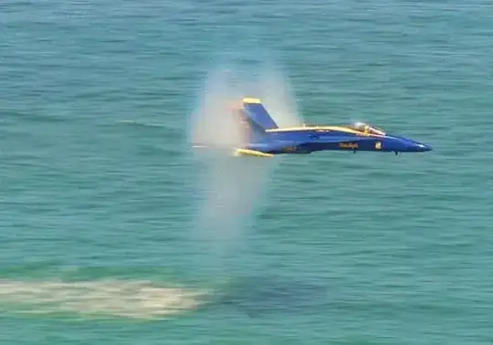

The airplane one can be qualitatively seen in pictures of aircraft flying low over water.
Jet over water

For a low-flying airplane, the airstream directed downwards is significantly more concentrated, leading to a higher pressure increase on the ground. (key word "ground effect", and the things visibly in the picture of the F18 seen above.)

Now, it turns out that the lift near the surface does something special, called ground effect. This increase in lift is so pronounced that entire vehicles have been built to take advantage of it. One of the largest such "planes" was the Russian-built ekranoplan. @Dale's dramatic picture of an F-18 skimming the ocean looks awesome, but doesn't directly imply ground effect, because we know these jets can fly at tens of thousands of feet. Whereas, the ekranoplan couldn't even get 100' into the air, because it is completely dependent on ground effect, which is the increased lift from air pushing against a nearby surface (like the ground, usually).
