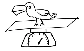

Okay this is a bit of an old classic, but I don't think I've heard a good reasonable explanation for what happens: If you put a cage of canaries on a weigh scale and they take off does the scale still register the weight of the canaries? Does it matter if the cage is sealed or open to the air? What happens if there is no cage but a canary flies over the scale?

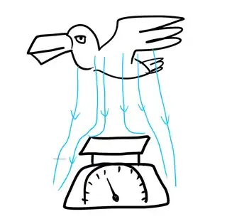

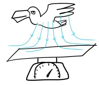

A bird is very much like a rocket. To go up a little, it needs to displace an equal weight of air down. So even if a canary is standing on the scale or hovering in the air, the weighing scale wouldn't make any difference (No matter if the cage is open or closed).
Notice that I used the word "hovering." If the bird accelerates upwards, it would need to displace more air than its weight. So then the weighing scale would show a higher value than the bird's weight at rest.
However, this is only true if the weighing scale can capture all of the air flowing down from the bird. If the platform is small, the reading would be less because the weight is now distributed between the ground and the scale.

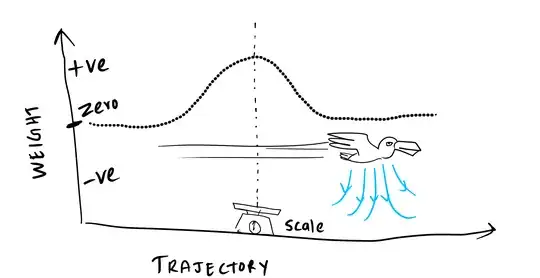

What happens if no cage but a canary flies over the scale?
The weight would fluctuate and would show a peak when the bird flies right above the scale.
