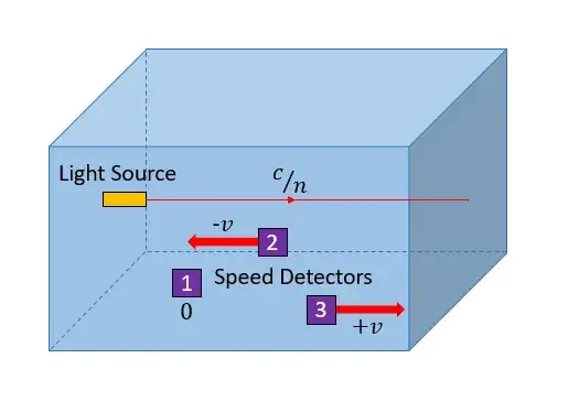

I tried to frame my question visually. So, let us consider the following image:
The entire setup is in a medium of refractive index not equal to unity. The light source is at rest with respect to the medium. The violet coloured squares below the light beam numbered $1,2,$ and $3$ are speed detectors which we can use to determine the speed of light beam with respect to the reference frame attached to them. $1$ is at rest with respect to the light source. $2$ moves parallel to the light beam and towards the source with a speed of $v$ and $3$ moves away with the same speed. Now my question is, is the speed of light beam detected by the three detectors equal? If it's vacuum we know they are equal. But what happens in this case?

Let's use the Lorentz transformation to calculate this. Let S be a reference frame, in which a coordinate system $(t,x)$ is used. Let S$'$ be a frame moving in the $x$ direction relative to S at speed $v$. The Lorentz transformation asserts that if event A is at $(t,x)$ then its coordinates in S$'$ are given by \begin{eqnarray} t' &=& \gamma(t - v x / c^2) \\ x' &=& \gamma(x - v t) \end{eqnarray} where $\gamma = (1-v^2/c^2)^{-1/2}$. Now consider a pulse of light that starts from $(0,0)$ and propagates at the speed $c/n$ relative to S. For example, there could be some water at rest in S, and $n$ is the refractive index of this water. At time $t$ in S, such a pulse will have reached the event $(t,x) = (t, ct/n)$. The coordinates of this event relative to S$'$ are given by \begin{eqnarray} t' &=& \gamma(t - v (ct/n) / c^2) \\ x' &=& \gamma((ct/n) - v t) \end{eqnarray} Now the coordinates of the starting point are $(0,0)$ in both frames, so we can find the speed of this pulse relative to S$'$ by using the distance traveled divided by the time elapsed: $$ \mbox{speed relative to S}' = \frac{x' - 0}{t' - 0} = \frac{c/n - v}{1 - v (c/n) / c^2} = \frac{c/n - v}{1 - v / n c}. $$ If you are familiar with the formula for addition of velocities, you could find this same result by applying it. We now find that when $n=1$ the speed relative to S$'$ is equal to $c$, but when $n \ne 1$ the speed relative to S$'$ is not equal to $c/n$.
The above formula gives the speed that will be measured by your detector number 3, if we take it that the detector works in the usual way by measuring distances and times in its own rest frame. The result for detector number 2 will be $$ \frac{c/n + v}{1 + v / n c}. $$
Another question that arises is the speed of the light relative to the water. That is just $c/n$. As soon as one says "relative to the water" then to calculate it you must use the rest frame of the water. End of story. But someone might ask instead, what is the rate of change of the distance between the light pulse and something floating in the water? If, relative to some given frame, the water is flowing at speed $w$ and the light is moving at speed $u$, then the answer to this question is $u-w$.
