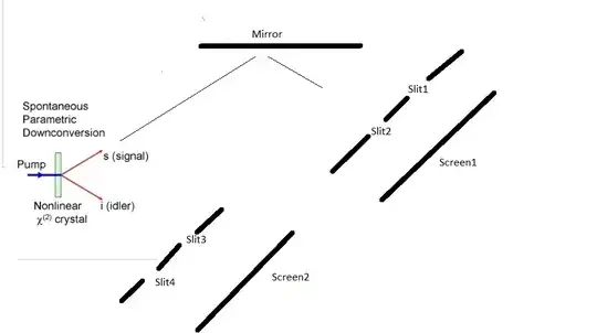

Thus it has to collapse the wavefunction. The signal photon goes to the mirror, reflects and goes through slit 1 and 2 and goes to screen1. The idler goes directly to slit3 and 4 and to screen2. The two photons in this case have a common wavefunction (entangled), and in this case I will either:
  1. see an interference pattern on screen1 and screen2 (coherent reflection does not change the state of the mirror), because the common wavefunction is not changed
  2. will not see an interference pattern on screen1 and screen2 (because of radiation pressure, the change in the mirror's momentum is detectable, measurable), and the common wavefunction is changed
Question:
  1. Will there be an interference pattern on screen1 and screen2?
Knowing that a photon has gone through a particular slit will prevent interference, but knowing that a photon has gone through a given pair of slits will not prevent interference. If recoil is measured at the mirror, we will know that a photon has reflected and has gone through the slits 1 and 2, and an interference pattern will indeed be formed on screen 1.
Note: the interference pattern will be affected by the mirror's recoil. The photon will transfer a tiny portion of its momentum to the mirror, so will go through the slits with a slightly longer wavelength, and as a result the interference fringes on the screen will be slightly farther apart. The heavier the mirror, the less momentum will be transferred and the less the interference pattern will be affected.
Let's complicate your experiment a little bit. Run photon s through a beamsplitter so that it can follow either of two paths to the mirror, and make the beam(s) narrow enough that one of the paths can only be reflected to slit 1 and the other can only be reflected to slit 2. Path s1 hits one half of the mirror and path s2 hits the other half of the mirror. Now, reflection of a photon on path s1 will give the mirror a clockwise torque and reflection on path s2 will give the mirror a counter-clockwise torque. The wavefunction will presumably take both paths, but the mirror's recoil can be used to accurately predict which slit the photon goes through. Will there be an interference pattern formed on screen 1? The answer in this case is "NO", because the mirror's recoil (clockwise or counter-clockwise) will constitute a measurement of which slit the photon passed through.
