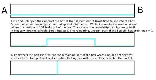

Imagine a particle in a very large box which takes years to travel from one end to the other. Alice and Bob are outside the box, on opposing ends. Each can remove their side of the box to check if the particle is on their side of the box.
Around the middle of the box, but outside the box, a star explodes. Alice and Bob agree to both check if the particle is on their side of the box when they see the star explode.
If Alice sees the particle on her side, we would expect Bob to not see it on his side, but the problem with this is that wave function would have to collapse instantly over all space in the box. In other words, it's non-local.
If the wave function were to collapse locally over time, it would start where Alice observed it, and information about the collapse would propagate at the speed of light to the other side of the box. But since it takes years to span the box, the probability distribution would still be non-zero probability on Bob's side.
Since it would break conserved quantities, a particle would not be able to be detected on both sides of the box, so it seems like the wave function collapses non-locally.
I think a non-local collapse looks something like the following.
I say it's non-local because the part of the probability distribution closer to Bob's side is changing by Alice's discovery of where the particle is or is not. A positive or negative observation by Alice affects Bob's chances of detecting the particle on his side. This is a non-local cause and effect.
Is this correct? This seems like an experiment that could be done. For example, a long tube has only an electron inside. The detectors Alice and Bob are photon detectors on each end of the tube. Turning on a very strong magnet on each end of the tube is equivalent to Alice and Bob opening the tube and looking inside. If the electron's spin flips in response to the magnetic field, then a photon is detected and may be detected. The time between turning on the magnet and detection of photon tells us where the electron was. If we run the experiment many times (throw away results where no photon is detected because electron spin did not flip or photon did not hit photon detector), will it produce a distribution of detections which is "uniform" (ignoring interference patterns), or will it produce a distribution which is more concentrated as you get further away from the magnetic field source (magnetic field is only on when we want to detect).
Further clarification: I understand the particle is everywhere in the box as some state before measurement. I understand that the particle IS the state. Measurement just forces the particle to be in a pure state. And, it seems like this transition from superposition to pure state happens instantly. No time passes. But my question is about what happens in the time between when Alice looks into the box and when she measures the position. As she sees that the space in front of her does not contain the particle, does this altar the particle's state? Does measurement of where the particle is NOT affect its state?
I have found this answer: https://physics.stackexchange.com/a/476738/159153 But just like the commenter on that answer, I am left unsatisfied with this story. The reason being, if negative measurement affects state, then I am still wondering how Bob's side of the box seems to be affected instantaneously.
Also, could this resolve the paradox seen in the delayed choice quantum eraser experiment? Since simultaneity can be broken by changing reference frames, it can also be fixed by changing reference frames. We can find a reference frame where the 2 events, detecting the particle on the main detected, and detecting the entangled particle in one of the other detectors, happens simultaneously. And if the wave function collapses instantly, then there's no paradox in this frame of reference.

It's non-local in the sense that you said: Bob's wave function must be updated as soon as Alice makes a measurement, by setting $\psi=0$ in Alice's detection region and renormalizing it to 1 everywhere else. Up to changing the phase, this is the ONLY way to change the WF after measurement which doesn't allow faster-than-light communication between Alice and Bob. You can check by insisting that the probability that Bob finds the particle is unchanged whether Alice chooses to look for the particle or not that this is the case.
Physics (including QM) is local in the sense required by special relativity, basically that there is no FTL communication. There are other types of nonlocality like this one which are allowed. How you interpret this physically depends on interpretational questions. But there is an underlying nonlocality of a certain sort in QM.
Edit in response to Croolsby's comment: You said: if Bob's WF is changed when Alice measures the particle, won't he be able to tell by measuring the probability of finding the particle on his end?
Answer: If Alice DOES find the particle, the probability that Bob finds it in his measurement is $0$. This has a detectable effect on the probability on Bob's side. So in order to make up for this, the WF must be scaled up in the case that Alice doesn't find the particle. Balancing these out is the only way that Bob cannot tell what Alice has done. In particular, we need
$P$(Bob finds if Alice doesn't measure)$ = P$(Bob finds if Alice does measure)
By splitting the right hand side of this equation into conditional probabilities, conditioned over whether Alice finds or doesn't find the particle, you can see that the only way for the RHS to equal the LHS is: If Alice doesn't find the particle, $\psi$ must be scaled to 0 in Alice's detector and renormalized (scaled up) everywhere else so that its norm is still 1. Up to a phase this is the only consistent way to make both sides of the equation equal.

Let me reword your premise a bit.
There exists a system spanning some region of space. Two observers Alice and Bob, at rest wrt each other, simultaneously measure some observable quantity of this system at a previously agreed upon time. The observers are separated by space and do not affect each other or the system except for by their respective acts of observation.
Your question then is,
Does the act of observation cause the wavefunction of the observable to collapse throughout the system instantaneously?
Let me reword it to say
Does the act of observation cause the entire system to acquire the observable's eigenfunction instantaneously?
In short, yes.*

Application to the particle in a box
There a few problems with the premise you provided
  1. Once the box is opened, the change in boundary condition stipulates an old and a new wavefunction even before any collapse related modifications could be made to it via measurement.
  2. While the old wavefunction was a sinusoid, the new wavefunction is zero everywhere with unit norm. Since such a thing doesn't exist, it must be localized in some way in the form of a wave packet (most likely the sinusoid before the box was opened).
  3. Till the time the particle's position is detected, the wave packet may have spread beyond the boundaries of the original box or moved. The light cones would therefore need to extend in both directions from both observers.
  4. Even if we assume that the particle stays in the box, your middle picture of wavefunction collapse is IMHO incorrect
  • After Alice's detection, due to unit norm, the indicated "blue step" on the right can't exist. Alice's detection implies a delta at the detected position which consumes all the norm.
  • Why should Alice's light cone stop propagating once it detected the particle?
  • Since the effects of detection propagate causally, why should the pregnant area of possible detection's on Bob's side not get its own detection spike too? After all, effects from Alice are still in transit. Note that you can't invoke "a single source of truth" argument to nullify the truth of the system's wavefunction - which from Bob's perspective is perfectly valid.
So what would really happen?
  1. The wave function evolves as per a dynamic potential. This potential at $t=0$ restricts the particle to the box. At $t>0$, it restricts it to regions where its absence hasn't been detected. Such a wavefunction is evidently complicated.
  2. One can circumvent all this by considering the box and the particle inside to be a giant entangled system.
  • The opening of doors is an act of measurement. The system instantaneously collapses everywhere to its eigenstate. The particle is sitting duck at some point.
  • Alice and Bob can read out the particle's position when their causal cones reach it. This has nothing to do with the collapse of the wavefunction. This way there is no ambiguity as to what is the collapse inducing actual measurement : the act of opening of doors or the light cones reaching the particle. (see On Clarifications below)
You make an important point in the following
What you have described is an entangled system and thereby non-local in its update of wave-function. The absence/presence of particle at Alice's location is perfectly (anti)correlated with that at Bob's.

You are asking in the comment "the probability distribution which tells you where the particle might be, and upon measurement, the particle's state collapses to one location."
Now it is very important to understand the difference between two things:
  1. the probability distribution which tells you where the particle might be
  2. the probability distribution which tells you where the particle is
Classically thinking, you would say, it must be 1. The particle might be at different places, with different probabilities, but not at the same time.
In QM, it is 2. The particle is actually everywhere in space, it is delocalized, when it is traveling in space (like a photon) as a wave. The probability distribution describes the probability of finding the particle everywhere in space.
Wavefunction collapse is a phrase that is confusing, it just means realizing one piece of the probability distribution.
It is a misunderstanding of this dubious word "collapse", which really means getting one instance from a probability distribution, in your question "wavefunction of the whole universe,", more complicated than the wavefunction for the scattering of two protons, but the principle is the same. One has to look for the effects of this particular point from the probability distributions describing it.
Spontaneous collapse of the universal wavefunction
You only realize this one piece of the probability distribution upon measurement. Until then, the particle traveling as a wave is delocalized.
You are basically asking if we have two detectors at two ends of the box, how will the detector at one end of the box know that the particle was measured on the other end, so it cannot be measured there too.
